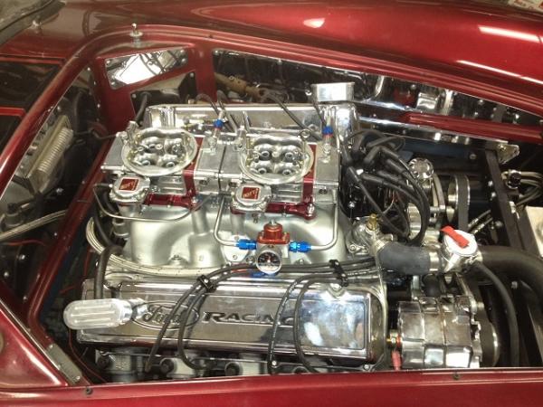

I am just finishing a new 547 with 4.500" bore, roller cam, Kaase P-51 heads and Quick Fuel Dual Carbs.... Had to install a somewhat taller scoop to get an air cleaner to fit..... Should all be finished within a week....CAN'T WAIT!!

You guys running the 550+cubes in these cars sure got my attention. Do me a favor keep me informed,would really like to hear how these motors work. Have you given thought to how you might gear the cars?
