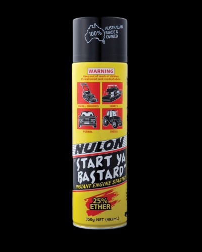

Posts: 296
This is all ya need!!
LOL!
Don't think we can get that brand up here. Several of my gas fired mowers, tillers etc. have been referred to in that manner.
