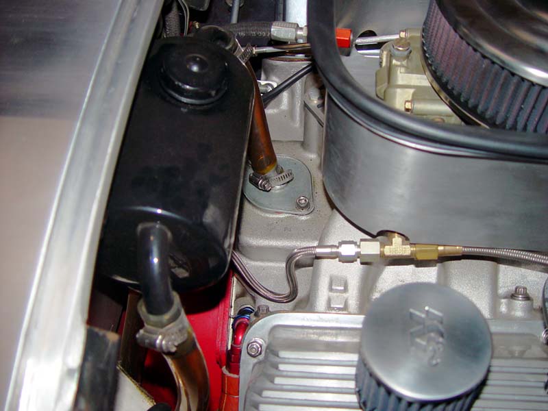

This shows the separator a bit better. The top transparent hose facing the viewer drops down to just below the frame so that the wind sucks the vapor out. The one draining from the bottom simply goes down to the oil pan to a tube next to the oil level tube which you clamp the hose to. I use clear tubing simply to see what's going on.
