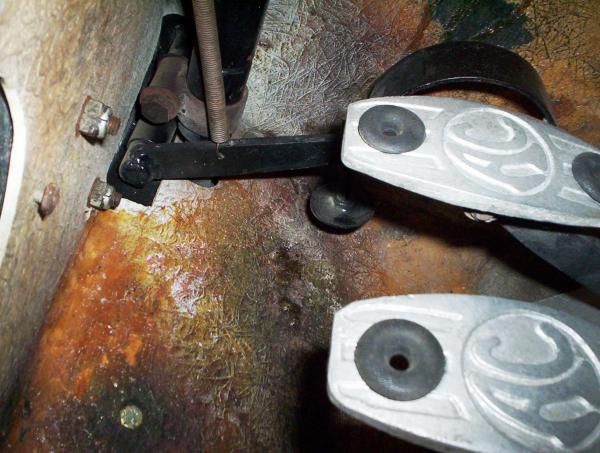

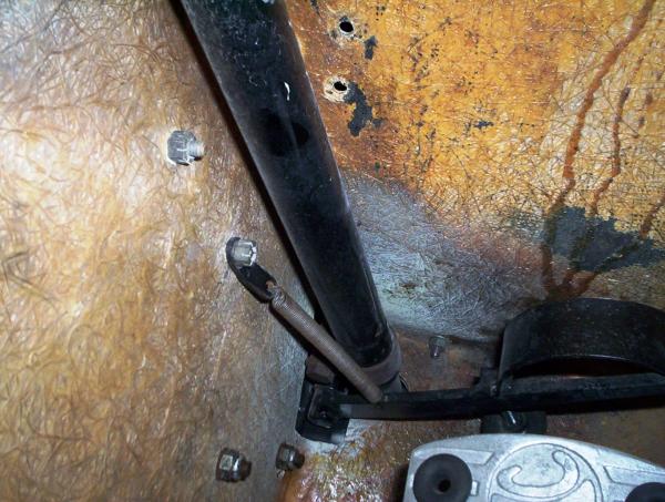

The recent Kirkham crash due to a stuck throttle made me wonder, how many of us are running dual carb return springs or a carb return spring and an accelerator pedal return spring?
It looks like the originals ran them (or at least some of them). I know that my pedal was drilled for it, but it wasn't installed (which I am correcting). Here are two pics of CSX3021 (courtesy of Mickmate) showing them installed. (Mickmate also has the tab washer and spring if anyone wants it).

Originally Posted by Z-linkCobra View Post
I hope thats not the only return spring on the throttle....is it? If it is thats a little scary.
No, it would have had that accelerator return spring plus a carb return spring. The accelerator return spring is bigger than the carb return spring.
