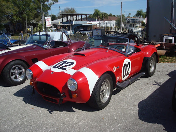

Well some of you might be wondering what has happened with the cobra adventure. After settling into snowbird life in Riverview we went to cruise nights, a Christmas car show and a Deeper South Cobra Club cruise to the Nav-A-Gator restaurant. Enjoyed the warm winter weather and cruising in the Cobra.
I kept putting off finishing up the details of the cars history with her past owners that I promised. In January I started to work on it and my computer hard drive crashed. It had all my recorded conversations, notes and pictures on it. The local computer guy said it was all gone but my computer wizard at home says he can retrieve it all for me. When we get home I guess we will see. I can recreate most of the info but it will be a royal pain.
On our way back from the Nav-A-Gator the car started running rough at freeway speeds and acted like it was running very rich. I found a tuner that was a EFI expert and took the car to his shop the 10th of February. He was very busy but promised to work on it as time allowed. When he got around to working on it the ECU wouldn't seem to hold the changes he made. He played with it for several days and finally talked to the folks at HALTECH and they felt that the ECU unit was probably bad and needed to be replaced. I had been having trouble finding someone that could tune the system so was reluctant to put the same one back in. I called Bob Reem at Imagine Injection to see what he recommended. He told me that they now were using a FAST EZ ECU on his injection system and had had no problems. So I ordered the FAST EZ and wiring harness from Bob and had it shipped to the tuner in Florida that was working on my car. He installed the new FAST ECU and started the car up on the Dyno and it ran for a few minutes then everything went dead. He calls FAST and they tell him to send the unit back and they will test it. It is now April and we have no car to take to the 24 Heurs de Florida but more importantly we are scheduled to leave for home April 16th. FAST puts a rush on a new ECU module (the original was fried) and we get it April 11th. The tuner puts it in the car and I'm supposed to pick the car up the 13th. Wow 3 days to spare. I don't want to say anything more as I'm afraid that I might jinx this.

The jinx has happened. Please excuse me while I vent. On February 10th I took my Cobra to Rob at Ford Speed Racing in Largo, FL because the car was running rough. He was busy but could fit me in around some other jobs. When I called them someone only answered 1 out of 5 calls. Left many messages only got one call back in 9 weeks. This should have told me something but what the hey maybe he was just busy working on customers cars. He told me that he was having trouble getting the ecu to take and hold changes. Then February 24th he tells me that the hard drive on MY laptop computer has crashed and he is having to wait for an adapter for his computer to come in to finish the tune. May 10th Rob tells me that the HALTECH ecu still won't hold the changes and he thinks the unit is bad and needs to be replaced. I then contact Bob Ream at Imagine Injection who recommends that we replace the Haltech with a FAST EZ system that he is now using on most of his FE systems. May 23rd the new FAST system arives and Rob installs it. April 1st Rob calls and tells me that the FAST ecu has failed. While on the Dyno the car just shuts down and hand held input screen is blank. The unit is sent back to FAST and tested. Test shows a burned mother board usually caused by by power surge. People at FAST and Bob Ream tell Rob what to look for so there are no further electrical problems. April 12th the replacement ecu arrives and Rob installs it. Puts the car on Dyno and notices amp guage is jumping arround. Shuts the car off and replaces the voltage regulator. Amp guage is now steady and he goes for test run. Car shuts down again and he pulls the car back to shop. Rob calls Dick with bad news. April 14 Dick has car towed from Rob's shop to our home. I then buy and install winch to pull the Cobra into our stacker trailer. The 17th of April we will leave Florida and stop the 26-30th in Memphis (the home of FAST) and link up with Toney Duncan who is a expert at trouble shooting the FAST ecu. Hopefully that will be when this story turns good again. The cost of this part of the adventure: new laptop $380, FAST EZ ecu & wiring harness $1,269, Ford Speed Racing bill $1,723 ($880 is Dyno time), replacement FAST ecu $586, Tow home from shop $125, winch for trailer $100. $4,083 worth of fun and car still doesn't run. At least it was running when it went to Rob's shop. Would I recommend Ford Speed Racing? I think not. Sorry to vent but I do feel much better just getting this off my chest. I will let you know how things go in Memphis.

Well I am a happy camper again. We left Florida the 17th and stopped in Atlanta till the 22nd then to Birmingham till the 26th. We headed for Memphis dodging all the tornadoes. Met Tony Duncan and went to FAST/ Comp Cams where they tested the ecu and confirmed that it was burned out by a power spike. Tony pulled all the ecu wiring and checked for shorts or miss wiring. Then checked the charging system. He found the voltage regulator was incorrectly wired and that the MSD box had a loose tach drive wire to the ecu. (when the wire worked loose the injectors shut down) The FAST engineer recommended changing the alternator to a single wire internal regulated one for better voltage control. We did all the repairs and the Cobra started right up and with the self learning feature of the EZ system every time we drove it ran better. It now accelerates better than ever and is running like I had wanted since FEBRUARY 10th. We were able to cruise a bit in Memphis and even stopped by Graceland to offer Elvis a ride but were told that he had already left the building. If you ever need help with fuel injection diagnostics or custom tuning and calibrations I would highly recommend Tony Duncan of EFI Diagnostics. He is based in the Memphis area but the FAST enjineer told me that he travels all over the country working for racers and car builders.
