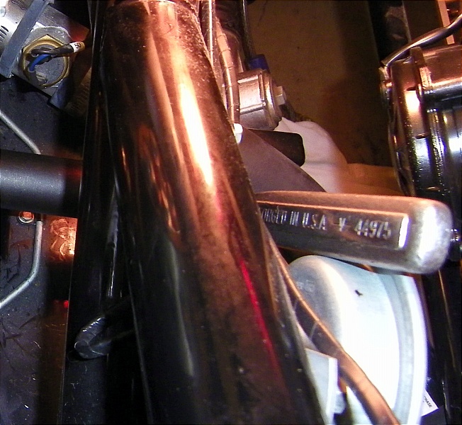

Ahhh, Chas... anyway, I've had the same half inch drive Craftsman HD ratchet wrench now for over 35 years and, during that time (but not in the last couple of decades) I can vividly recall bouncing on the end of a pipe that was over the handle, in order to break a nut loose. Let's see, I was probably about 180, plus bouncing... yeah I think that gets in to the three hundred ft/lbs range. Soooooooo, I'm thinking that wrench is good for 400 ft/lbs or more.

Yeah, yeah, yeah... sometimes they don't line up as nicely as a ratcheting wrench will. Now, unlike Chas., who has never hit the gym in his life, you'll be able to spot this unique tool that I used with that same ratchet wrench to break the balancer bolt loose a couple of years ago (even while my breaker bar was sitting idle in the corner...)

Chas. loves a close up shot of a tool, so here you go. Yep, this is a Vintage Oil Ball Craftsman 44975 1/2" Ratchet. I'm thinking you could probably lift both both Silverback and Chas., along with their bathtubs full of water, with this wrench.
