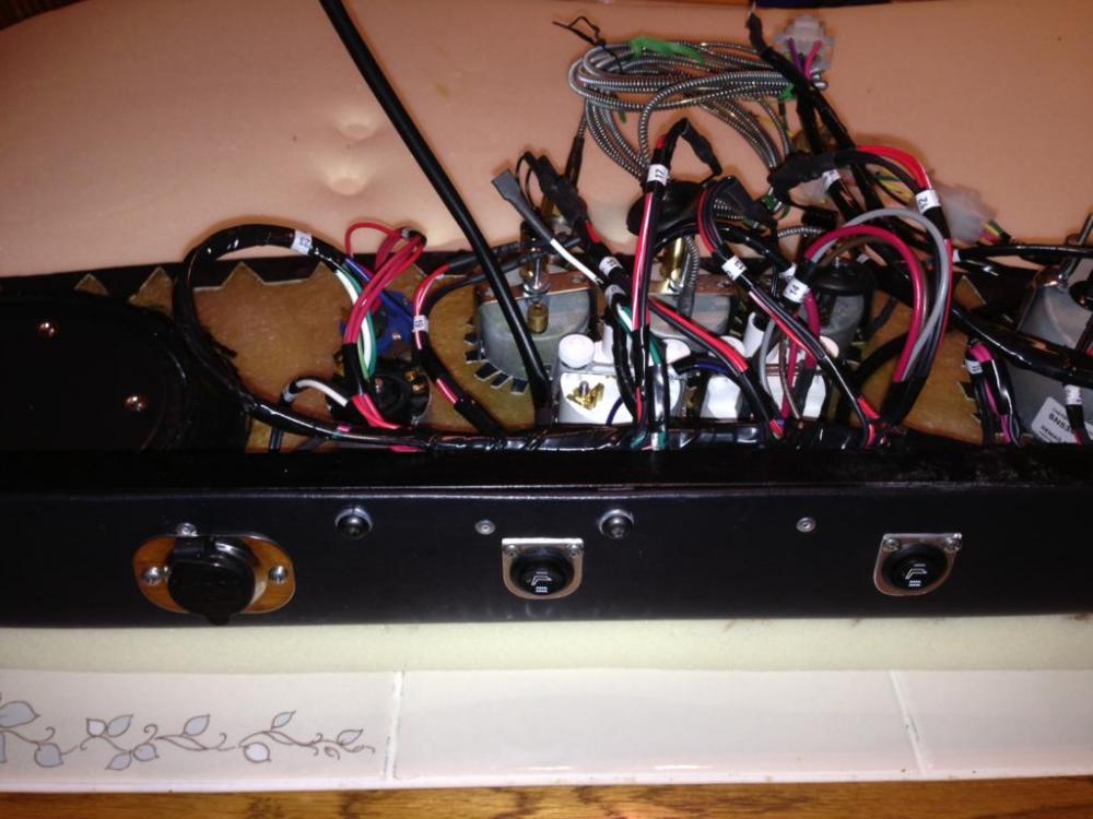

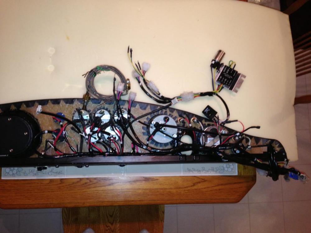

Have been working on the car with my son...mostly on wiring and suspension. My wife and daughter peeled the protective film off the aluminum and promised to come back to do the trunk.
The dash and firewall are wired and the wiper motor and mechanism are in. Love that old timey looking Lucas wiper motor.
Added a stainless steel accessory outlet and the heated seat controls hidden under the dash in the flange (Go ahead and flame me for the heated seats. I enjoy cold weather riding on my Harley and love the heated grips... I'm sure we'll enjoy the heated seats in the Sping and Fall).

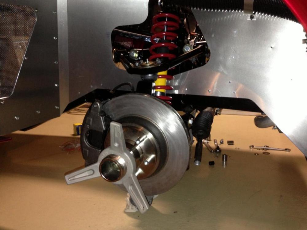

Suspension is mostly in. I don't have the jam nuts for the tie rods, so will install them when I receive the nuts from ERA.

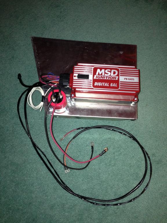

Mounted the MSD box and noise filter capacitor on the bottom of the glovebox frame.

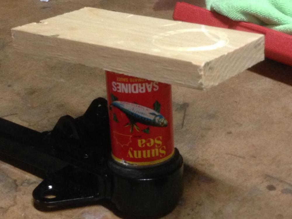

And, lastly, the metal reinforced boots for the lower ball joints require some persuasion to get them mounted. The recommendation was to get a short section of exhaust pipe, which is the perfect diameter to whack them in place. Well, I didn't have an exhaust pipe laying around so, before running out to the auto parts store, I rummaged through the pantry and discovered that a can of sardines in tomato sauce is also the perfect diameter I was more than happy to sacrifice the contents of that can to turn it into a tool. One whack with a plastic mallet did the trick. Asked my wife why she bought sardines in tomato sauce and she has no recollection of why or what she was going to do with them. Sure am glad they didn't show up on the dinner plate Have a Happy New Year!

I think the heated seats are a great idea. Was that option supplied by Era? Any details you can provide would be appreciated. Thanks.
Lippy

I purchased the seat heaters from cobraheat.com (warmseats is the name of the product) and had them shipped directly to ERA. They inserted the pads in the seats (the pads can be cut to conform to the seat size) and the connectors come out the rear of each seat in the center. There is an upper seat back pad as well as a seat pad, so should be pretty effective. Peter makes a note on the work order for Doug to see and Doug screws the side panels on rather than riveting them in place so you can remove them to route the wiring. He even drilled holes, inserted grommets and suppled some rivets in a little zip lock baggie to put the side panels on! So, when finished, nothing at all will be visible. Doug will also give you a drawing with recommendations for mounting the controls under the dash using the supplied "L" shaped brackets. I chose to cut those brackets in half and use the half that the switches snap into and drill holes to mount them directly in the dash as you can see in the photo. There was a nominal charge for their part, but no big deal.

Great progress. I'm impressed you didn't have any more of a struggle with the front suspension assembly. Keep the reports coming.

My son benches 240 so he laid on his back and pressed the control arms up and in and moved them around while I pushed the bolts in. I'm sure it would have been a real struggle if I did them alone. It was actually pretty easy, although I did hear him grunt a couple of times
