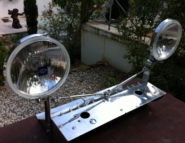

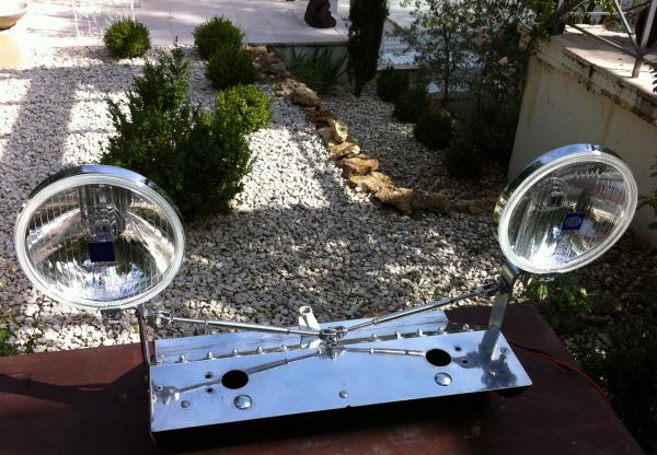

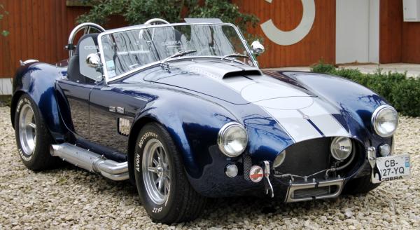

Default Made in France.
A big hello to all, with the automatic translator and French accent.
Here's what I've done myself on my FPS, with some simple parts, care and patience.
The objective is a very functional, but also aesthetic, I particularly cared for the details in this regard.
These two additional headlights seem to enrich the air intake area.
I paid particular attention to:
- Remove the headlights not to reduce the cooling radiator.
- Match the curve of the lighthouse with the oil hose to the radiator.
- Make all attachments that prevent vibrations.
Best regards from France.

Hi.
I founded the lights in France, of coarse. The brand is HELLA.
They are very flat, the diameter is 16 cm, and they are also long rang lights.
I shall answer to your MP.
Best regards.
Saint Ho.
