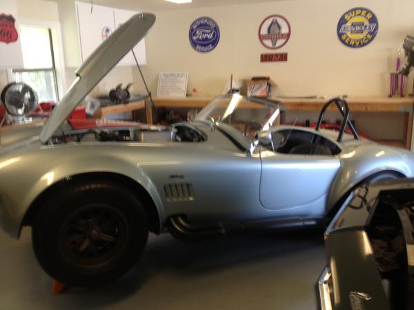

You can refinish them to look very original and with the weathered patina. My car get more compliments on the wheels than anything else. We color matched a 45 yr old Halibrand center then added black and graphite to the mix and sprayed the wheels on a home made wheel polishing machine using a detail gun and lots of reducer. Kept spraying until the final look was correct. As I drive the car, (4000 miles of hard driving in the last year), I don't clean the wheels. The accumulated brake dust from the CR Girlings and road grime makes them look even better. I only wipe down the original spinners after I reinstall the wheels-typically they are smeared with Never Seize after I get them hammered on.
It is doable.
GRUFF

Another couple of pics with more miles on them.

I've personally have seen John's Cobra and his wheels look like the real deal. I actually have been thinking about changing mine to the old wheel look myself....
