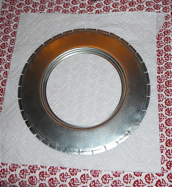

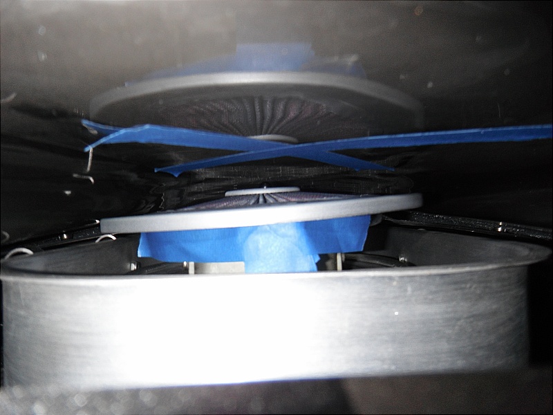

Progress...

Now, what do you think of that boss-looking new air filter top?
I get encouraged then have to hang my head after you ask me something like this................  (sigh)
... but you had two of them on your car.
OF COURSE YA DOPE- I WAS FEEDING 1308 CFM at WOT!
Chas.
05-12-2013, 07:17 PM
Posts: 22,017
... dang, and you won't even let me have one.
