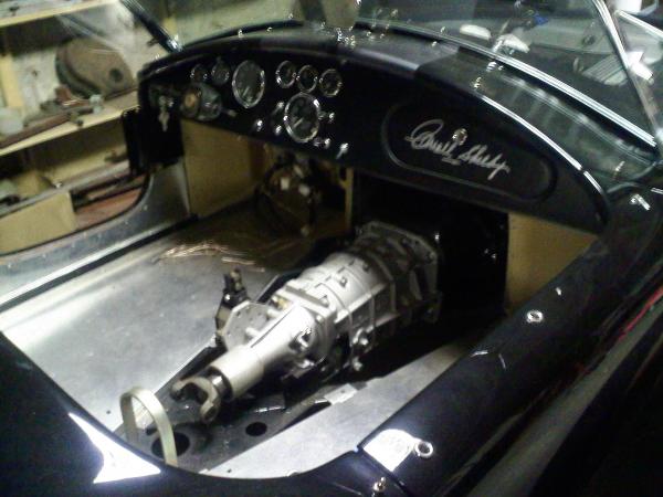

I installed my 390 and richmond gears all as one unit, no interior in the car, and it went in very easy.

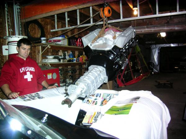

I have had the engine, bellhousing and transmission in and out several times as one unit. Easy job using a 2 ton engine hoist with a tilt adjuster from Harbor Freight.
Remove the left front wheel and support the frame with a jack stand.
Lift the motor trans over the front of the car, start tilting it down in the back and continue inching the hoist back along side the car. After the bell housing clears the fire wall start leveling the tilt adjuster.
Slowly ease the motor down onto the motor mounts.
Doing the job by yourself should take less than a half an hour.

Leave the alternator off. Radiator out. Everything else should be OK. Call me if you have any questions. C = 925-525-4700

Yes i had no seats no carpet but dash was in and was not an issue. I used a hoist from the beam in our garage at the time as our engine lift did not allow for enough room to get the car under it. This is the older ERA before they changed the frame and tunnel on the car.
