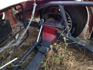

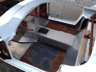

Ok guys, I finally got a bunch of pics up of the body in my profile so hopefully someone can tell me what kind of kit car this is...
Hope the pics are clear enough!

I can't help you as I haven't seen anything exactly like that. But I am sure that there are some on here that can help. I am going to put the rest of the pictures that you linked to in this post as it is easier for them to look at them than having to go to each link and back. Sorry that I can't be of more help.

I don't want to dampen your enthusiasm but you're looking at A LOT of work (insert "$" here) to get that car to a running /driving automobile.

Can you tell if it is an actual kit, or is it more likely someone just through it together and built it themselves??

The chassis is strictly a home built item and is not any kit that has been on the market, ever..Unless you are making it in to a static display, wall art, or an ultra cool mailbox, you are better off passing on it. Even if they were paying you to get rid of it.

Until I saw that front cross member everything else points towards an attack cobra, bit not with those front rails or the cross member, which now screams "home built".
The more I look, the body itself is indeed out of the Attack Cobra molds, all the oversize flares, spoiler on the rear, front nose opening all coincide with an attack cobra body, there is not another like it on the planet

The front cross member,the double cowl hoop, and the tubing on top of the frame rail all look like a Johnex, but the top rail on the Johnex curves down just ahead of the crossmember, whereas yours continues forward to the front of the frame. Big clue : the Johnex had a perimeter frame with a unique curved crossmember under the seating area, with additional diagonal bracing going forward and outboard. What does yours look like underneath ?

MM: The visable parts of the frame are similar, so the possibilities are : Jonex frame modified, or home built inspired by johnex, or just plain homebuilt. I have a Pic of the Johnex that I will attempt to attach, and the owner can use that as visual aid.

Yes, I'm aware of the early chassis as that was what I had at the house in the early spring. The pictures shown by the OP are close, but not where it counts
