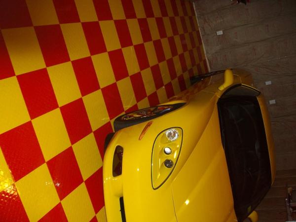

got my race decking 7 years ago and i went with the tuff shield because it was much shinier but i dont think the upgrade was that much back then. My tiles have a diamond plate pattern and if you need to dolly your car around i would not get that pattern, just flat would be the best. The back of the tiles are reinforced so they are extremely rigid. I just sweep the floor once in awhile and mop the tiles, using some soap only if needed. Oil and fluids wipe right off with a rag

That's a colorful floor.  I haven't seen a smooth tile from Race Deck. They do have a tile called CircleTrak with a coin pattern - I wonder if it might work better with casters? I've found a few comments on line that it's a little harder to get a car moving on dollies but once moving is about the same. Still thinking it over.

"That's a colorful floor. I haven't seen a smooth tile from Race Deck. They do have a tile called CircleTrak with a coin pattern - I wonder if it might work better with casters? I've found a few comments on line that it's a little harder to get a car moving on dollies but once moving is about the same. Still thinking it over."
7years ago i had no idea i would ever own a cobra, still cant believe mine is getting built now. The awesome part is the cobra will be red and is going into the garage with the race decking and the vette will be going in the crappy garage, so it will match the flooring still. Its funny how sometimes things work out perfectly but in my life that barely ever happens. Good luck with whatever you go with and post pics if you decide to do any floor covering.
