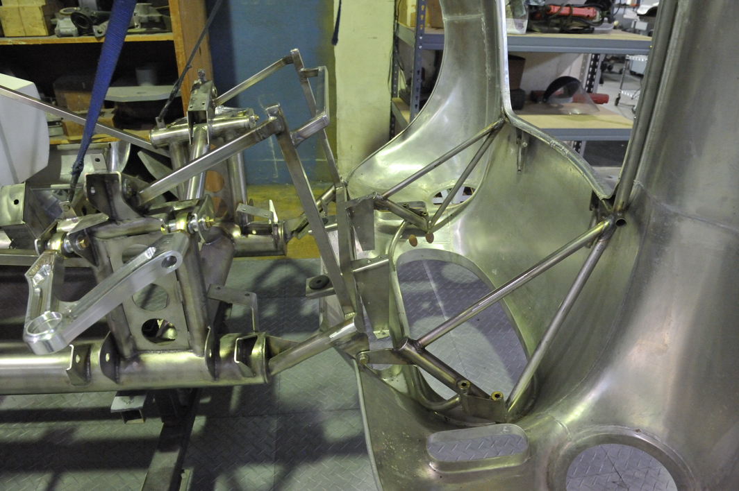

Hi Larry yes the photo I sent is of the passenger side top of shock tower, there is nothing stamped on the drivers side top of shock tower, it is perfectly smooth and nothing looks altered.
Bill S is looking for pictures of the door hinges and trunk latches etc, I will take those tomorrow and send them to Larry.

Also send a shot of the drivers side of the shock tower

Just wondering...since there is so much about this car that reminds many of the knowledgable members of a Kirkham, could this body have been sourced directly from the European company (can't remember which country---Poland?) that produces them for Kirkham and the numbers added at a later date?

What do you know, I have a picture of a Kirkham shock tower with a serial number on it.
Kirkham flip top cobra under construction:
Zoomed in on driver's side shock tower showing serial number and tapped holes to right of serial number.

Well, it looks like there may be progress...now to address the issue of that VIN.

I'm leaning towards an early Kirkham but I don't know why the COB number or why it doesn't have a Kirkham number. As a "COB" chassis, it should be right hand drive and this chassis was made left hand drive. Interesting for sure!

In viewing all the pictures, I really don't think that's the work (and hinges, bolts, aluminum work, etc.) of KMP. In my mind, the work done on that car just doesn't meet the standard KMP level of excellence. No chance.
I'd guess a one-off by a talented amateur.

After days of looking over the OP's pictures (thanks Larry), my conclusion is as follows:
Kimmin's (sp) body and frame
Not ever legally imported to Canada, but in Canada just the same, rumors of one that was brought over the border supposedly in a truck filled with snow blowers back in the mid to late 90's have been quietly floating around, but have never been substantiated, could this be that chassis?
Regardless, COB 0666 or COB 666 is an invalid/false/fake/illegally stamped chassis number and by someone doing so, risks the confiscation and disposal of said chassis by TransCanada and/or it's judicial arm.
OP's major problem is that there is no MSO/MCO, therefore he will not be able to legally explain it's lineage or prove it's actual age to TransCanada. If there is a MSO/MCO, then OP has a little more disclosure/explaining to do, past his "amnesia" as to how he came upon the chassis/body years ago, and just now was able to secure it in his garage again. No offense, but I can remember 95% of the 300+ cars that have come through my personal collection over the years, and I'm the guy with ADHD.

How did you come to that conclusion? (Kimmin's built)
Please give details of the workmanship or items that support your findings!

Bill S, why does this thread now need to turned into some kind of conspiracy. This thread was supposed to be all about if the actual manufacture could be identified. and no, it didn't come across the boarder with snow blowers.
Amnesia????? I explained in previous posts and have had numerous private conversations with forum members on how I became in possession of it.
I purchased it in the US, it is only a body and chassis, it was cleared by a local Cobra manufacture, I traded it for work towards the Cobra you see in my avatar and now I bought it back. Like I said it was in storage here for over 7 years.
I can't make you believe me so lets move onto to what the thread is supposed to be about. If I was a Cobra expert like yourself I wouldn't have need to start this thread, I am only looking for information and as I stated earlier it doesn't mater to me who made it but I thought it would be nice to know and also I thought it would be of some interest to others.
As far as Cobra's coming into Canada, a few years back there was a complete Kirkham roller, pained blue on E-Bay and the car was on Vancouver Island BC Canada?

As far as I know, Bruce did panel beating but didn't build frames. Repaired yes but not from scratch anyway. He did a number of Hi Tech bodies but this car isn't a Hi Tech.

To do so would advertise the differences in frame/body/attachment (those are your hints), something I'm not willing to do, sorry

So you bought it new from a US manufacturer, then you would have a MSO/MCO, shipping records, your "local Cobra manufacture" who cleared it (cleared it how, through TransCanada, if that is the case, they hold their records for 25 years, a simple call to them could garner the information you seek, or open Pandora's Box which you should be worried about) or some record of payment to them, why not just say that, and post that in the first place. Your lack of transparency, your withholding of vital information, when you are asking for our assistance, seems a bit questionable at best. Further, no conspiracy on my part, I think I spent quite a bit of time going over your photographs, digging through my 20+ file boxes, comparing countless other photographs, of other aluminum body/chassis manufacturers (both commercial and private in nature), along with going over all of your previous posts on the subject and spelled it out, as I now see it, quite clearly. Sorry if that stings a little, but I am blunt when it comes to such things, preferring the facts, as laid out, by you, to speak for themselves.
Or, I guess our time, energy, and efforts are not as important as the time it took for you to ask for our free assistance.

Brian said the paint was ground away to expose the number better.
Would you use 80 grit (those are what the sanding scratches show) to take paint off, I think not
