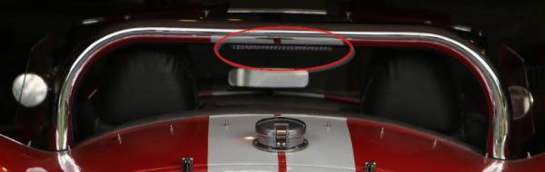

Originally Posted by cycleguy55 View Post
With my West Coast Cobra I was able to mount an LED strip on the bottom surface of the full-width roll bar. It's effective and relatively hard to see unless you're looking for it.
You can see it here: http://www.clubcobra.com/forums/pict...ictureid=18164
I don't have a photo of it lit up, but suffice to say it's quite visible.
This the LED strip I used: https://www.princessauto.com/en/deta...ip/A-p8493074e
I tried a number of different ways to attach the strip, and had no end of frustration finding something that would bond to the material used for the LED strip. What finally worked was clear hot melt glue. It's been there for 4+ years now and still holding.
Brian
For those willing to drill holes, take a look at the 3rd brake lights used by Mazda for the MX-5 / Miata. In particular look at 2008 and 2016 generations. The latter appears lower and wider then the former - pick your poison.
Can you PM me a picture of what you did with your WWC I have one and I would like to see this option for safety reasons as well.
Tks buddy
Lou
Tks buddy
Lou
See post #26 in this thread.
Brian
Did you drill a hole in the rollbar to run the wire?
Yes, right by the LED strip, then through the roll bar and out the mounting socket.
wesalbert likes this.
