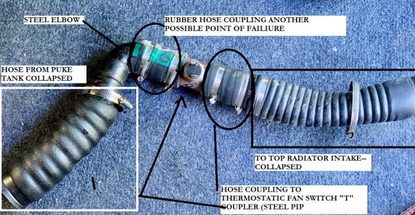

UPDATE ON THE CAUSE
After much digging it all came down to the hose that holds the thermostatic switch for the fans( top hose) it was a contraption ready to literally blow with two hose components totally collapsed due to the weight of the design of this contraption. a brand new hose is being professionally made and hopefully this situation is corrected.
Basque1
