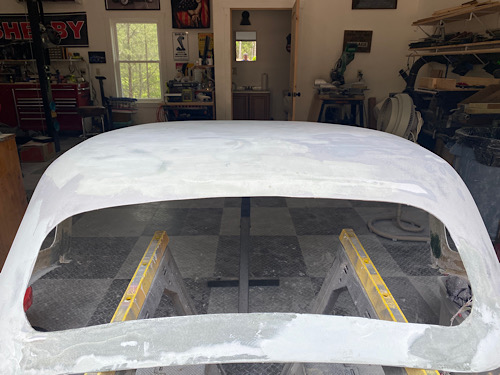

Default If at first......
The longer I looked at it, I knew I wouldn't be happy with that gap below the back window, so I'm having another go at it.

Posts: 178
I think I’m sneaking up on it…the real fiberglass guys are probably in therapy by now.

Posts: 178
Thought it was time for an update. I finally figured out why it looked a bit off from the back. The window opening wasn’t parallel to the bottom of the top, so a bit of glass work and cutting got it pretty close. I alost worked on the lower edge under the window and got the radius looking better Also had to make an adjustment to the lower flange on the PS, but it’s all progress.

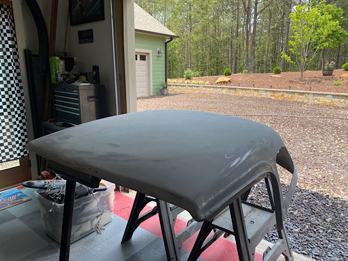

Default Looking for help/advice from bodywork guys
Ok, I've laid about 3 thin coats of stranded filler and one of regular filler (which I haven't sanded yet) and here's where I'm at.
From the front.
From the side.
So, how to deal with the dip in the front to back shot? Too much to fill? more glass?
Thanks in advance.
John
  #38 (permalink)
Old 05-13-2023, 02:05 PM
DanEC's Avatar
Join Date: Apr 2009
Posts: 4,527
It might be possible to place it upside down with on some supports and pile some weight on the low area and let the weight and the sun do its thing over the course of several days. But that could just spread the problem around. So yes, fiberglass mat and resin are probably the best way to go.
ERA 782 Running
  #39 (permalink)
Old 05-14-2023, 05:29 PM
john4337's Avatar
Join Date: May 2009
Location: Copperhill, TN
Cobra Make, Engine: Factory Five Racing, 306, E cam
Posts: 178
Thanks, I’ll let you know how it goes

Default Progress Update
Thought I'd post an update. I ended up adding some more glass, then filling and blocking it down with 80 grit. its not completely symmetrical, but I'm not sure it was when I started. Plan now is to lay down some high build primer and block it some more.
