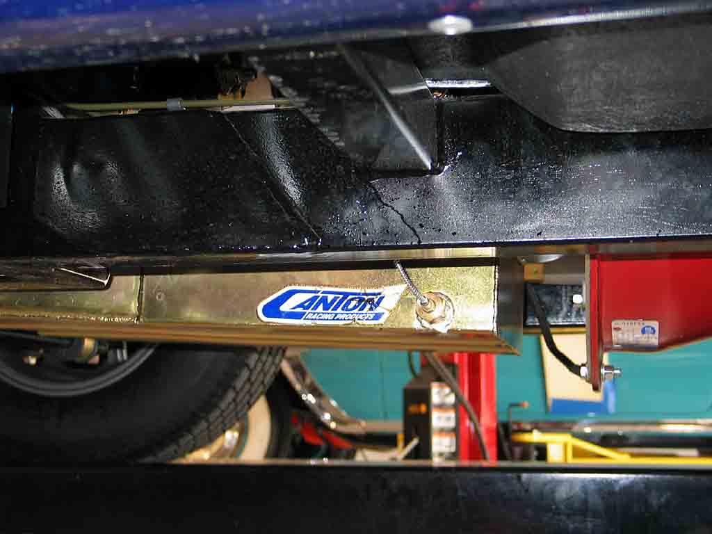

Like Sal said and I went a little further...check my pics....
Perry
