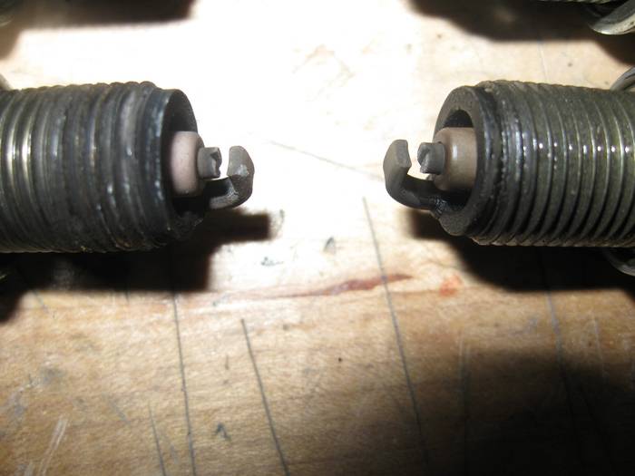

Here are a couple of your pictures that may help the guys get an idea of what your plugs look like. The first two you have numbered as # 8 and # 4. Glad that you have narrowed it down as this will help anyone else that may run into this in the future. Not the normal type problem.

How are pictures of his plugs related to this problem and the solution he found??? What am I missing?
They're not related; you missed nothing. The plugs were simply an interesting sidebar that was totally unrelated to the real issue at hand.

What is not normal about the 4 & 8 plugs?
I think they're fine. Clean 'em off a bit, gap 'em, and put 'em back in and forget about it.

Not really unusual to get a little oil deposits on the back cylinder plugs. The valve guides pull a little and the back cylinders valve train is submurged because of oil being forced to the back of the valve covers.
