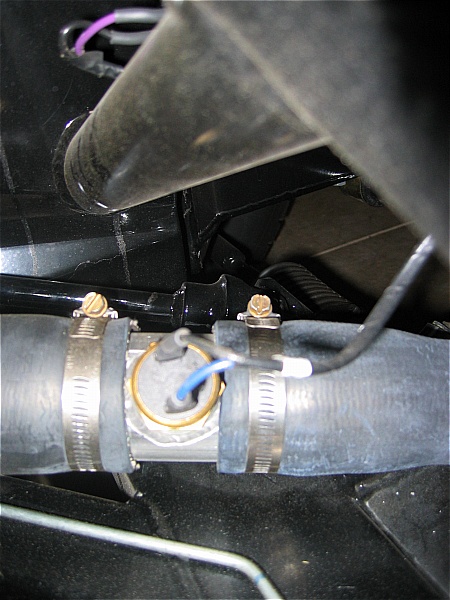

Posts: 22,013
Originally Posted by elmariachi View Post
I may just sh*%-can my heater plumbing and use that manifold hole. It not like I need a heater in Houston in a car with no top.
Don't do that -- just use a tube in the bottom of your lower radiator hose with the sensor welded in to it. It works very well and it's another job you can do largely while sitting at the kitchen table. Here's a shot of mine:
Yep, that's exactly how my primary sensor is installed in the upper hose. I was trying to avoid having another one of those in the system but I guess it really doesn't matter, its hidden down below anyway.
