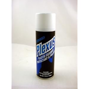

Old 04-16-2010, 04:41 PM
Posts: 22,017
Originally Posted by STEVE-O View Post
Also Zaino sells a nice polish for plexiglas.
This is what I use on the plastic wind wings and sun visors. It's very good. Some say it's the best, but who knows....

Post
After having two sets of the wings break that I bought from Cobra Restorers, I took one wing and one visor down to the local glass shop and had them make me wings and visors out of Lexan. I also had the word COBRA in block letters put on all of them in proportion to the size and they have been on since 1998 without a scratch or problem. I used a product that is much like what Patrickt posted above. Total cost back in 98 was $40 dollars including the lettering. I believe the ones that I was buying from Cobra Restorers were right at $100 dollars then. I don't know why they kept breaking the area around the bolts that held them on, but they did.
