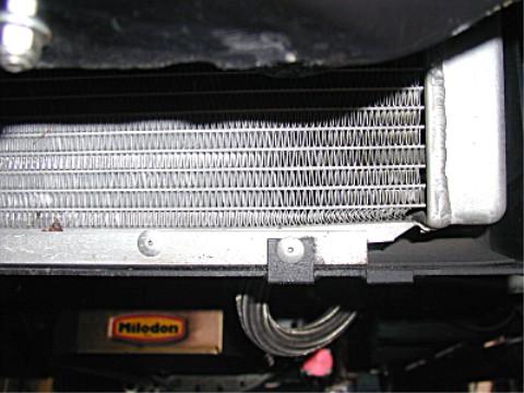

I got my rad from Afco Racing and had them remove the filler on top, install
-16 AN fittings top and bottom and install a drain petcock. My rad tilts forward. Here's an old pic and you can see the angle on it.
