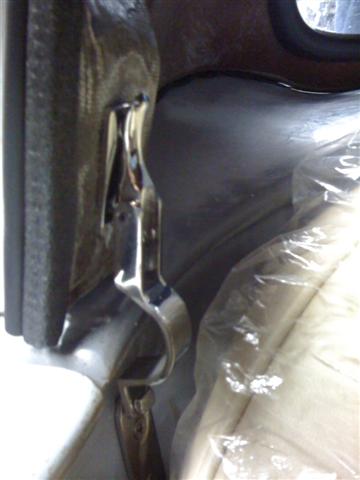

Oh yeah Russ, forgot to ask. Do you have any good close-up pics of the hardtop latch you used just behind the door?
Thanks
Greg

Greg, I will take some tomorrow and post them. In fact, I'll take pics of both the front and rear ones.
One thing I forgot to mention. We glued the fabric but left some areas loose so that when you walk up and touch it, the fabric is loose just like a soft top would be. Take notice of the picture of the car front on and you can see some looseness in the fabric over the passenger area. There is more of that elsewhere in an effort to allow for the fabric to move a little.
Russ
Thanks
Greg
Hello Greg, Here are a couple of photos.
http://www.clubcobra.com/forums/pict...pictureid=2534
http://www.clubcobra.com/forums/pict...pictureid=2533
The chrome strip around the back window is the plastic locking spline for the double channel rubber extrusion. It is pseudo chrome (most likely aluminum Mylar) encapsulated under a clear plastic protective coating. Take a look at my albums here on the Forum and you will see a close up of the rubber.
