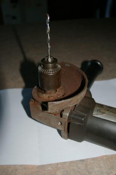

Recently Sambo was chasing a 90 degree drill, I was also in need of one on the weekend, and came up with this idea. It's an old 1/4" drill chuck that I re-threaded to suit my angle grinder, 10mm X 1.5mm. It works well. Good for tight spots.

Now you have a 10,000 rpm drill. Better wear eye protection, and maybe a flak jacket too!!

Most hardware stores sell flexible hose attachements also that allow you to get in tight spots.
I reckon you would go through a lot of drill bits going at the speed of a grinder, especially in thick steel.

I second that - good idea, too bloody dangerous though!

I didn't recommend this for everyday use, just for the odd occasion. Yes the drill bit would get hot in thick steel, but the steel/ aluminium on the cobra is no problem. As for the danger, it is no more dangerous than a grinding disc. The outer edge of a 100mm disc is travelling at 52m/sec @ 10,000 rpm whereas the 6mm drill bit is only doing 3m/sec, if the disc came apart, which can happen, much more shrapnel to dodge and travelling faster too! I've got one of those angle attachments, and find it hard to control in tight spots as you have to hold the drill and the attachment at the same time. Anyway it works for me. Peter.

that angle grinder doesn't run at 10,000 rpm so the danger isnt as bad as most of you think

My messages weren't intended to be negative. I think Peter was pretty creative to make a 90 deg. drill from a 4-1/2" angle grinder. Like many of you, I've got many tools I've made or modified thru the years. That's part of being a gearhead on a budget.
My first message was to let you guys know about the miniature 90 deg. threaded-bit air drills. Unless you're in aviation maintenance, you may never have seen these.
My second message questioned another member's statement that 4-1/2" grinders don't run at 10,000 rpm. I have a Makita and a cheapy from Harbor Freight (which has been a surprisingly good tool). I looked this morning, and the Makita is labeled at 10,000 rpm no-load spindle speed, the Chicago Electric (Harbor Freight) at 11,000 rpm. My cutting and grinding discs, and flap wheels are labeled for 13,200 or 13,300 rpm.
No doubt others of you may have something different....and that's OK.
As Peter said, the speed, whatever it is, is not an issue for his use on thin aluminum or mild steel. Trying to drill thick steel or stainless steel would probably melt the bit, but he's not doing that. Again, hats off to his ingenuity.
