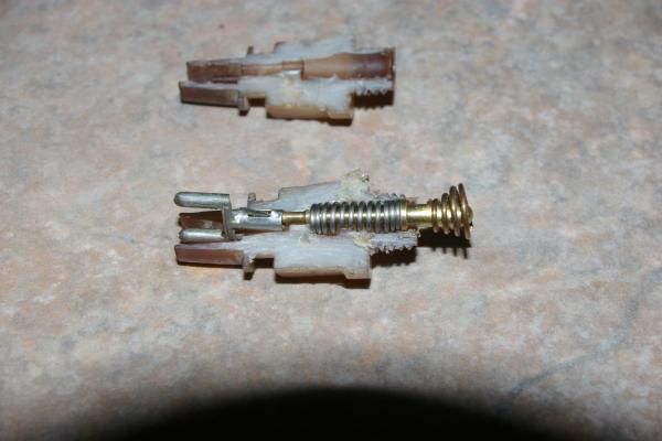

Stumpeater, when you say "I have got it working by removing wire"
Are you saying that the dash light is on on your car until you remove the wire?
If so then I personally would say you have wired the switch correctly, and infact the switch has been tripped, to reset the switch, it is just a simple case of removing switch and pumping brake pedal a couple of times, then refitting switch.

I was scratching my head over the switch as well, on all the time, until i realised the 2 poles are connected inside.
The solution........the switch earths through the mastercylinder, so you only need a single wire returning to the dash lamp, ie 12v ign supply to the lamp, then the earth running from other side of lamp to either pole on the switch. When the plunger is pushed in by the piston (as per Gary's eloquent description) it completes the circuit and on goes the lamp.

My original circuit looked like Boxheads diagram.
So I cut an old one in half to see they are in fact joined inside, hence the query "Where did the second wire go to on the Ford"
Point taken, good question.
