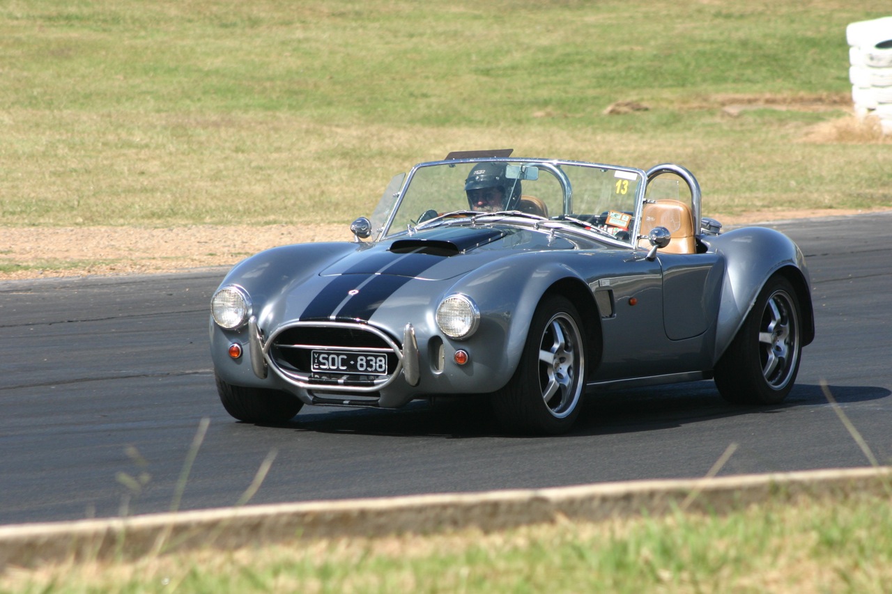

This may be an obvious question, posed by a newbe, but I did notice from some of the pics of shelbyfest that a number of builders have chosen to "trim" the sill area between the front and rear wheels with a chrome strip..
Live side pipes are awesome but personally I have the opinion that if side pipes are not live then they can look a little naff, so this option appeals to me.
If you have made this mod then I would be very interested in where you sourced the materials and how you went about it. My cobra is going in for a full resto (stroker, under body, paint, engine bay, front suspension etc) so any info would be most appreciated.

This was the car I was referring to:
http://1.bp.blogspot.com/-EG9Mh8hJEz...0/IMG_1288.jpg

I dont know the car, but it does look like a Harrison.
Here is one without the trim strip.
Cruising in 5th

And one with...
Geoff
