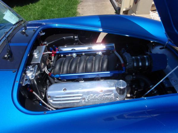

Originally Posted by Pecal View Post
Tenrocca
Your engine bay is sensational. You've really thought a lot about simplifying and tidying it up. You've given me some real food for thought..

Sambo, the bodywork was done at Stylerod Panels in Croydon (who incidentally used to do the paintwork for Robnells).
The roll bar is for aesthetics - just like the head it's supposed to protect.
Damn that engine bay looks good Andrew, leave the bonnet off it shouldn't be covered up.

Hey Peter and Tenrocca,
what sort of connector do you use to attach your fuel line to the engine connection?
I went low tech (hose clamp) which is ugly and saw yours and was wondering what you used?
thanks
Gregg

Gregg-mine is a male an bung braised onto the inlet to the fuel rails. I think aftermarket billet rails will be nice when the budget allows. I'm pretty sure phil found an adapter to go from the stock inlet to an8 without any mods.

Greg
EFI Hardware in Mitcham supplied all the fittings and hoses I used. They supplied a male threaded fitting that I silver soldered to the steel fuel pipe. An Earls Speedflow right angle barbed fitting is pushed into the flexible hose and locked with the red collar you see. This then screws onto the male fitting. They're great fittings to work with and simple.

Peter,
Love your interior, is that an acess panel in the passenger side?
How does the LS3 feel to drive?
Aeroflow make some real cheap fuel rails, I think the set for the orphan were like $150.00. then you need to add a few fittings. Brazing the fitting like Andrew has done works best and eazier on the wallet.
Andrew and Ben have fantastic engine bays even with those silly engines in them, simple and very tidy works for me.

Thanks Peter, Andrew and Phil for the tip on the fuel rail connection. cheers Gregg

Originally Posted by Philm View Post
Peter,
Here's what it looks like with the fuel rails..

Some nice features on your car Peter.
Those ugly LS1's can scrub up ok with some thought on how to hide things. Phil M is the master of detail on stuff like this.
Mine still needs some small things that can be done better.
Ben

Gee I am never opening my bonnet when you guys are around.
They all look fantastic. I can feel my wallet opening for those Edlebrock LS! covers they neaten up those ugly coil packs etc
