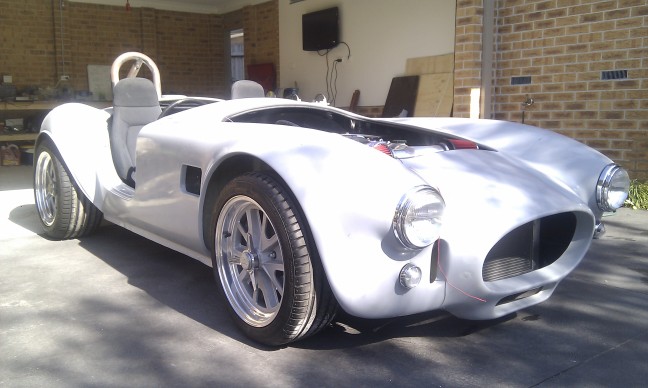

Ryder, no problem, photos shown below. They are basically the same as Sambo's but with centres closer to gold in colour. The rear tyres (9.5"x17") sat just proud of the wheel arches and the front (8"x17") didn't look out of place although when I purchased my polished versions, I adjusted both backspace settings slightly to get it just right. They are in as new condition with original boxes. I was thinking $1000 including spinners. I also travel regularly to Bowen to assist with transport if required.
No hassle if they're not to your taste as I reckon wheel style and size is one of the important choices to make. It's early days yet and there are plenty of options available.
Derek

Great intel DC...hereis the easy view version...Nice...
...and car looks great too !

They look nice mate - very clean, tasteful and the shape suits the car well! PM sent
