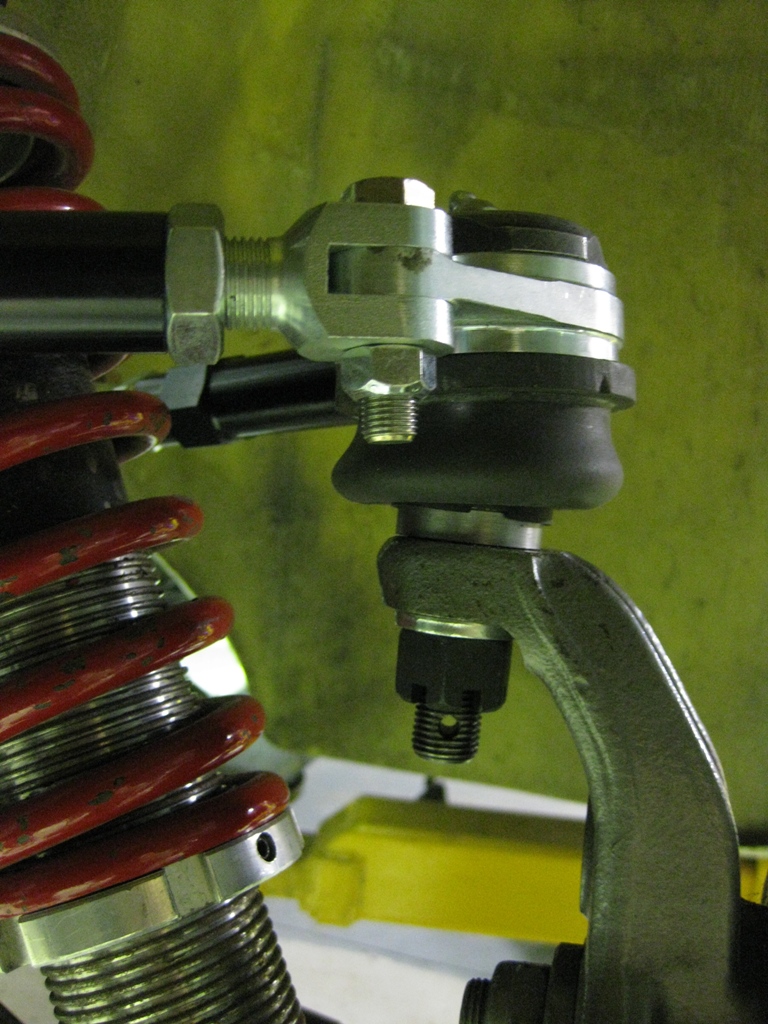

Nice work Slowy,
I did something similar with mine but used the FFR adjustable arms. Also had to make adapters for the Mustang ball joints into the Jaguar uprights.

Yes without your skills and equipment, I've had Marty on the case. He has previously done the same work for the FFR kits, very similar mods I believe.
Interestingly once I stood the car back on its boots I found I needed to wind the driver's side out 15mm to get a similar slight negative camber angle to the driver's side.
This was with the driver's side gear fully screwed in.
So am going to get Marty to shave off another 4 - 6 mm total off the driver side parts to give it a tad move adjustability inwards if ever needed.
Clearly the frame has some variance in it, the same as I found between sides with the bodywork and what I needed to open up to fit this gear.
By Friday I'd like to think the whole issue is sorted and that I'll have a car that tracks well for the moment.

That setup looks heaps better, stronger and less likely to break than other designs I've seen on this site.
Not a single HEIM JOINT in sight.
Good work
Dave

Marty does really good work.
I'm often hearng how Cobra chassis are not the same left to right. Surprising when they are usually built on a jig. I wonder if there are some errors in the jig. Could it have been a result of the front end hit?

Mike
Mike
I actually had that discussion with Marty this morning.
I dropped off the drivers side arms to shorten then a fraction more for better adjustment.
Marty said he and Greg straightened the chassis pretty spot on, so whether this is another one of those manufacturer's foibles, might not be too far from the truth.
This is certainly true of the diff mounting location in RMC and G-Force I believe, that then sets the whole alignment just slightly off.
Will be interested to see what Rob says after my visit to him next Friday.
slowy
