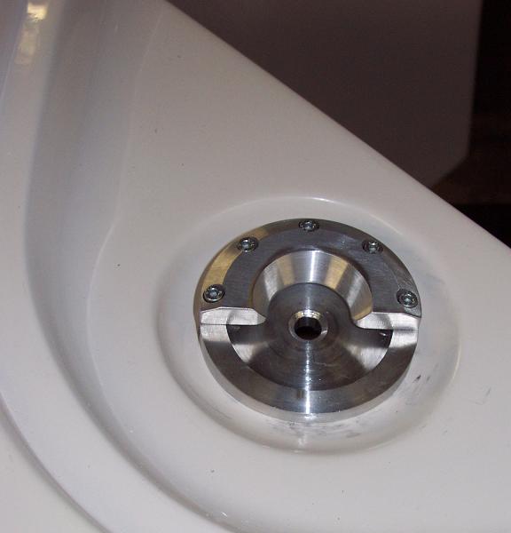

1.I notice a strange arrangement of holes drilled into your body where the bonnet locks would attach to. Could you post some pictures of your setup?

I didn't like the idea of the locking cam running directly on the glass as Ian does them. So a while back I machined up a billet locking plate setup. It bolts in to that recessed area and the cam from the bonet lock slides under a recessed section.
Here's a pic
