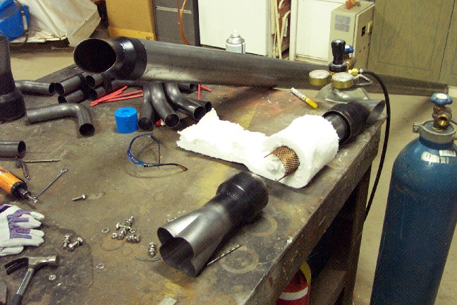

I have started on my sidepipes and thought I would post a couple of pics.
I have used a 3" collector with a 4"-3" reducer that has been cut down, same with the outlet end but have used a 3" bend for the tip.
Both the front and back assemblys have a sleeve welded in from the inside to locate the outer 4" section of the pipes, these will be attached with socket head cap screws around each join.
I have located 4" cats which will sit in the 4" pipe and the remaining will be a home made hotdog muffler.
Expanded metal mesh rolled into a 3" pipe will go up the centre and as you can see in the pics on my gallery ceramic fibre wool will be wrapped around it.
The wool is used for boiler refractories and the like and is great stuff its not even itchy if you get it on your skin. You can hold an oxy torch to one side and your hand to the other, so hopfully the outer of my pipes will not get too hot.
The wool is not that dear either, enough for a set of pipes would only be worth about $20. I buy it by the roll so if anyone wants some give me a ring on 0407 110641.
I had thought about sandwiching it between a sheet of ally or stainless over my pedal boxs to keep out the heat

Looks great!!!That is one long pipe there Gav......
Sidepipes is one thing Im very keen to have a go at, but I really only have a vague idea how they all come together (despite studying yours and uncle Mikes posts al length!!). Have either of you guys actually made up drawings\measurements\material lists (ie instructions )?

Looking realy good Gav,
Who made those cleanly formed collectors? The ones I get need a heap of panel beating before they look any good.
You can also buy 3" perforated tube for the cores. It might be easier than rolling a section up.

Thanks everyone,
Its amazing what you can do flying by the seat of your pants!
I think you will find the camera has been kind to the collectors they're OK but I'm not going to write home to mum about them.
As for the long side pipe, I'm building a limo!!!!
All my bits where bought from a local muffler shop and and came from Pacemaker I think?
The expanded mesh I'm using is in the shed and I'm too tight to buy some perforated pipe until I know whether these will sound OK.

Gav, are the pipes stainless, any idea on the end cost of parts?
Old 04-29-2006, 04:09 AM
Gav's Avatar
Gav Gav is offline
Location: Mildura, vic
Posts: 2,349
I had toyed with the idea of stainless but could not be bothered with the welding. The pipes you are welding together require to be filled tig gas whilst welding in order to get a reasonable joint with no leaks or porosity.
To be honest I just can't be fagged and the coatings available for pipes now are great.
All up I have bought 20 small radius bends, 4 large bends, two flange plates for the heads, 2 colectors, 4 reducers, 2 3" bends for the tips, 2 3m lengths of 1 3/4" pipe and 1 3m length of 4" pipe.
All up it has set me back around $800 bucks.
The four larger radius bends are the killer as I was charged for a die change for their bender.
I was going to tig every join but will probably just use the mig in the engine bay and linish the welds.
Gav
