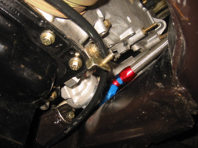

Not to sure on your situation (torana & 302 + Z10) but my DRB with a 4.6 and a standard oil filter there was no way I could even put the oil filter on! Actually if you look closely in the attached pics even with a remote oil filter setup the torana 'sub frame' had to be notched so that under hard driving conditions the sub frame would not hit the remote setup.

Looks like a remote mount is the way to go, looks good Blair, that engine sure is a tight fit.
