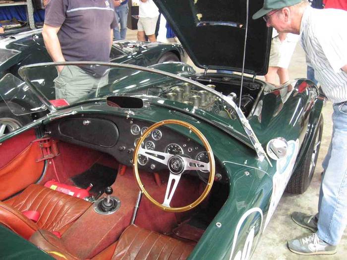

I though that some may be interested in the dash from a 'real' Cobra up the road from here (two of them at Bowdens at Bli Bli). Makes me feel better!

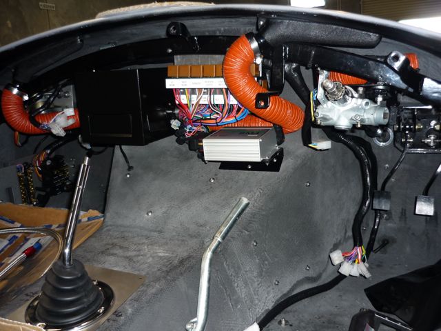

More pics behind the dash.

hey mando you running the sm4 alone or the cdi with it too
what u should do is get a small stereo mic extension
plug it into the sm4 and screw the other end into yr glovebox or dash
makes it easier when it comes to tuning
u dont have to fiddle round under the dash

Slow down Sideshow, what is a cdi and when you say "easier when it comes to tuning" do you mean the engine or something to do with the radio?
Regards.
Mando
  #34 (permalink)
Old 06-04-2009, 04:11 AM
Join Date: Mar 2007
Location: North Gold Coast, Qld
Posts: 820
the cdi is capacitive dischrge ignition
like an msd but much better
the tunign side fo it i was talking bout is when u tune the sm4 u need to plug in a cable from yr laptop to the ecu
i always fit a small extension and leave it in the car plug it into the sm4 then u dont have to stuff arund near the ecu u just plug in the cable to the ext that sits in the glovebox

Thanks a lot Sideshow, Ill ask the tuner when the car gets there. By the way do I have to connect vacuum to the jack on the SM4?

if u tune the neigne with throttle sensor then i think u leave it unplugged
and it is then used as a barometric sensor
if u run a boosted engine u need it connected to measure boost and u then tune the enigne using vacuum/boost
if u have multiple throttle bodies and boost u then tune it using throttle up untill 0vac/0boost then once u go onto boost u tune it using the vac sensor or map sensor as its called
i think they will tune yr enigne using throttle as its a tad more prescise when its non boosted when compared to using the map sensor
so maybe leave it off but check with yr tuner he might want it connected so he can measure vacuum
weve starte dplaying with ls1 ecus more these days
see what else we can fit them too
plus we are making ls1 dual tune ecus
should be a good thing flick a switch and u go from std tune to a performance tune
