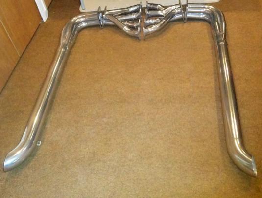

I replaced my side pipes with the 3" Classic Cobras with the louvers turned the correct way to scoop the air.
Buy the longest pipe you can fit onto your car. Turn the tips up to keep from bouncing the exhaust off the pavement.
Before I changed they could hear me a 1 1/2 miles away. Got a picture of a cop that pulled me over when he hear me four block away in a neighborhood of three story houses. He did not write me a ticket because he only "heard" me.
After the change I had no problem easily talking to my passenger at highway speeds. Quiet but had a heathy rumble at idle.
