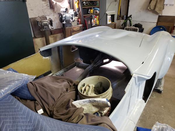

This is the 1992 classic roadster, I need the cowl hoop for, when I get the hoop built or bought, ill be getting started on it,

Putting photos in gallery with dimensions on hoop
The hoop is 1” square 1/8” tube and 1/8” flat plate with door hinge mounts in 3/16” that you weld in during door alignment
The 2 small 1/8” bent pieces they use for wiper mount and upper corners can be made out of 2 pieces and corner welded

Photos of the cowl hoop with dimensions are in my gallery. Adding a layout of the curved top bars in a few

Excellent, I can get started on it, ill get pics of finished piece, Thanks so much
