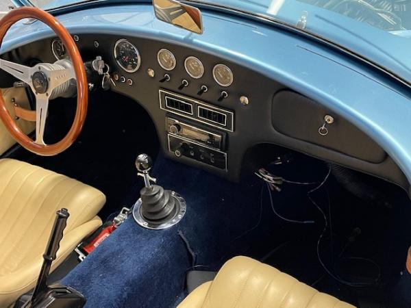

It has been a while since I have both worked on the CR or posted the status. This fall life kept getting in the way of either. Between a bit of travelling, working around the house, and severe colds 3 times (bit tired of that), I have made some progress.
I ended up selecting AR Torq Thrust M wheels in 17" so I couls get modern tires.
I finished the wiring (I think) and cleaned up the wiring harness under the hood. I know it would have been a bit cleaner for the harness there if not for the EFI. But each choice has a benefit and a loss.
Yesterday I did a test fit of the dashboard. It's the 1st time it has been in its spot since 2021, which was before it was redone in the black Vinal. I am glad I switched out the tan vinal on the dash. I need to take out the dash one more time to connect the heater control cables and connect the radio wires as you can see sticking out the left side of the lower dash extension.
I did not like the door sill with just the bare paint as I can see it getting scuffed quickly. So I ordered these carbon fiber sill plates yesterday. Will see if I still like them when they come.
Once the dash is back in I will look to starting the motor. Wait and see how many "wiring miss wires" I have since I found so many from PO.
