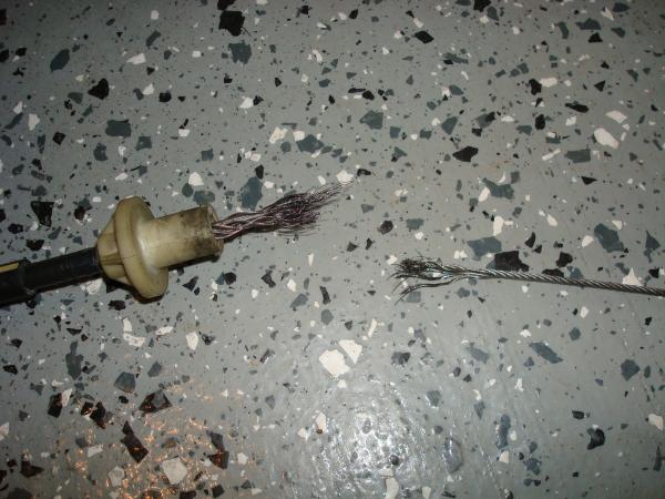

Has anyone had thier clutch cable severed and break where it goes thru the clamp bolt on the pedal assembly? Does anyone have a better , more reliable system they have used?

No its actually pinched thru a stainless bolt that has a hole thru it with a washer on each side? its truly not the best system thats for sure, may need to upgrade this winter lol

Most like;y its me overtightening the nut and washer assembly lol .You have to on these bumpy ass roads in canada or else it all falls apart. ha ha

cobra1066
That is the exact problem. It has been put through the firewall at an improper angle. Slightly wrong but it was wrong. If you get a new one and have it run through in the correct geometry AND the round "eye" is free to move when the cable is pushed, it wont break for 100,000 miles, really! I have truly replaced a dozen of them and everyone one,the geometry was wrong.
Us the same OEM Ford cable-re-align it and you should never have to replace it!
DV
PS The part numbers Terry supplied via "Spanky" are correct-NAPA has great replacement cables; 1979 Mustang 302 cable D9ZZ-7K553-B or Napa # 615-1008.
