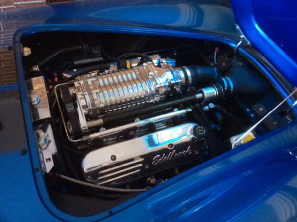

Cobra Make, Engine: Robnell Blown LS1
Posts: 296
It's an LS1 running about 4lb of boost with a Lunati hot rod style cam which is not ideal for a blown setup but it sounds like a cobra should.
It's putting out around 550 HP at the flywheel.
