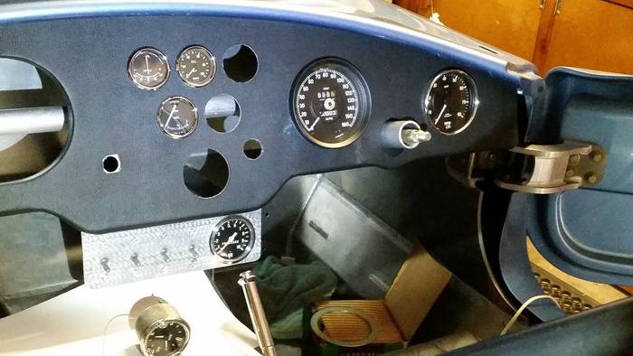

OK, so after the quick trial fit of the dash panel, might as well do a quick fit of the gauges that will slot in easily (ie not the bourdon tube temp gauges).....
Now to pull it all out again and attack the glovebox and glovebox lid.
Cheers!

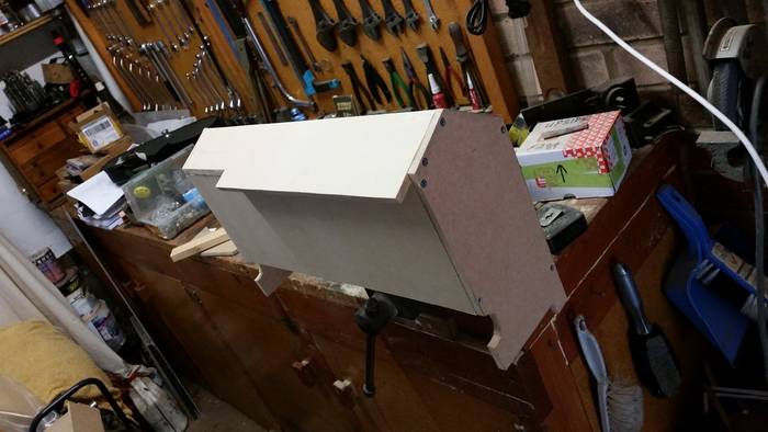

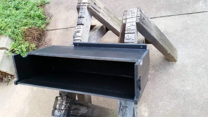

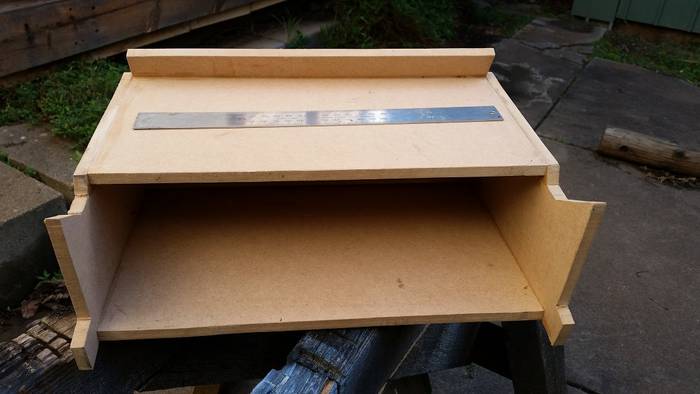

Progress on the 289's glovebox.
It's a bespoke design because of the proviously mentioned transverse structural tube, so ended up doing two iterations of the 'box.
Here's the first, at 330mm (13") wide...
Then realised that I could easily go wider withe the same mounting, so here's what v2 ended up looking like at 450mm (18") wide...
...and painted, ready to be bolted in...
More to follow on the lid.
Glen
Alfa02 likes this.

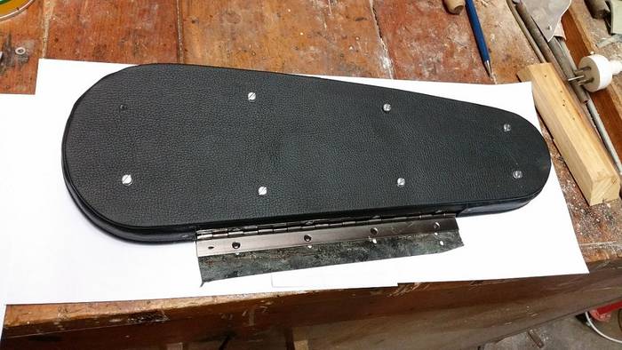

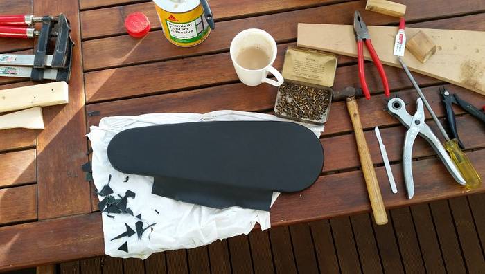

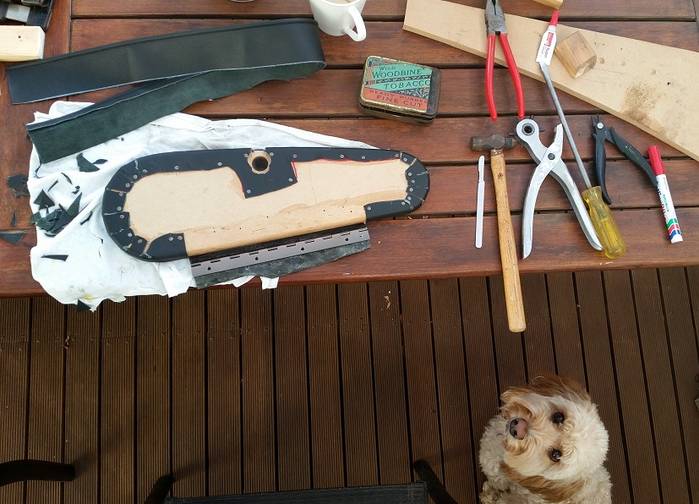

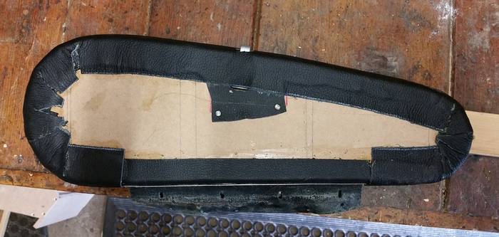

Here's the rest of the picture story of the g'box lid....
Rear side complete except for the leathered rear-side cover...
Rear side with its cover screwed on. The cover is 16g alum. alloy sheet, leather covered. The non-fitted screw (hole) is for the leather retaining strap.
Here's the completed glovebox lid ready to be fitted...

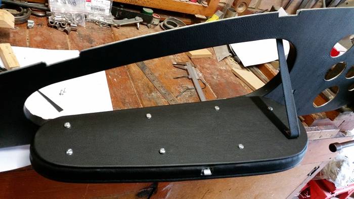

Trial fit, glovebox to dash panel....
....and from the rear side:
Taken a while, but finally coming together
Glen
