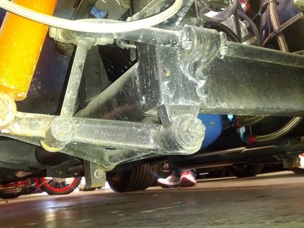

Here's a shot of the front suspension. Doesn't look like Mustang 2 to me.

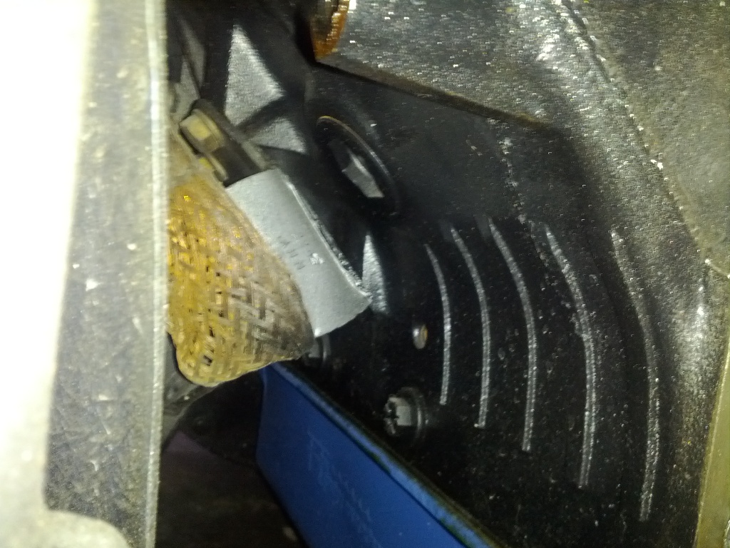

I managed to get the camera in to take a pic of the side of the block. I couldn't find any casting numbers but the screw in freeze plugs and cross bolted main bearing caps are the clues here.

Yup classic CCX/Jag front IFS right down to the missing bolt on the front control arm mount. Keep getting pictures like that Mike and we'll have the real stroy in no time.

With those ribs on the side of the block it looks like a replacement block from 1968 and on. Would also then be a Hydro block.

Doesn't appear to be a real side oiler,as the add states! Most likely a service block made till early 80's. Make sure u keep rev's under 6K, if you decide to buy. I know this wasn't part of original thread, but the improper side oiler add statement caught me. Sry! You might take a look @ ERA #134/1987 mfg. just posted on CC for sale site. Nice ride & a stated center oiler. great blocks for draggin & street use!
