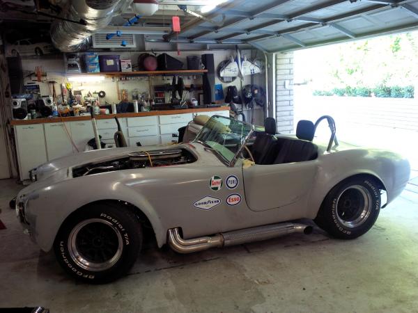

Default Rub pictures
Old 09-01-2015, 05:44 PM
Join Date: Dec 2014
Location: Scottsdale, AZ
Posts: 17
Rick, man you are full of info! Wish you lived next door! I just posted the pictures of the rub. Its a Jag rear and you can see on the black fenderwall, the rub. This is the passenger side, not the drivers side like you see in the photo of the car from a distance. You mentioned that your rear has front support bars. Are you referring to the torsion bars? Now that you see what I am talking about, whaddoya think needs adjustin?

Rick has an ERA with the Jag suspension mounted in a carrier that has two bolts at the top that secures it to the frame. Each hub has an adjustable rod link running forward to the chassis that locates the entire assembly (and thus position of the wheels) in the wheel opening. The carrier simply pivots around the two attachment bolts and everything is located front/rear by the links. I had a similar rub in the front of my driver side wheel well of my ERA and the fix was to lengthen both rod links by about 3/8 inch to pivot the entire assembly to the rear slightly.
How does the Jag rear assembly mount in your Contemporary? Is it bolted in solid to the frame? Does it have any rods locating the hubs front and rear?

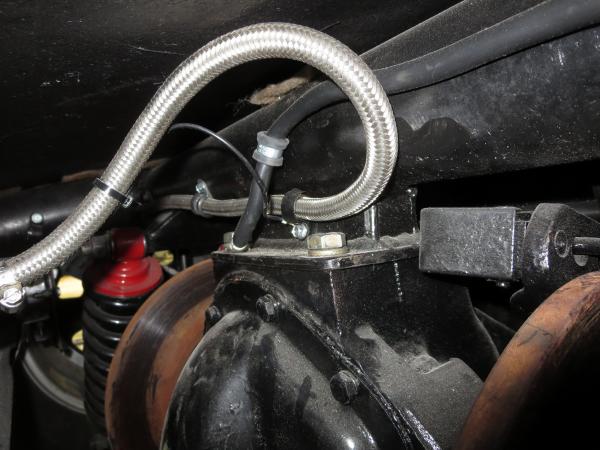

Default Diff mount plate 4 bolts
Old 09-02-2015, 04:24 PM
Join Date: Dec 2014
Posts: 17
Dan, I just posted a photo of the differential mounting to a plate on chassis. I do not have the carriage nor does it have the drag rods connecting the hub to the chassis, only a bolt on stopper that bolts to each drive shaft with two u bolts. It is about 3 inches long with a metal plate on the end an butts up to the frame. Each end appears equadistant to the frame. See the next photos. Would a bad or out of adjustment shock absorber cause this? I say this becuz if there are two shocks and one is set hard and the other soft, would that cause the up and down movement to twist diagnally instead? Rick makes good suggestion with the spacers but I really would like to find out what is causing this. I have 15 inch tires. The rubbing occurs over bumps or turns.

jrbruc84 Is it Bruce? If this is only over bumps, replace the shocks, but I don't think this will fix a body hitting problem. It's a tire rub. Put 1 thin spacer in the r/s of 1/8" I think that will clear the tire. The other thing is we don't know what the rear camber reading are? You might only need to add shims to the r/s drive shaft to help clear the body. Was the rearend apart? They might have not reinstalled all the shims and this will cause the same problem. Call me in the about 3 hours. Rick L.
