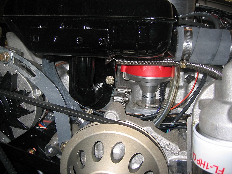

Does your tank look like this one from the Gessford site? I'm pretty sure that the ERA ones are not only shortened but spaced out a bit. I think Bob told me that the tanks they have now are made from scratch for them.

11-04-2009, 01:36 PM
Posts: 22,017
It should all fit with the billet MSD Distributor

11-04-2009, 01:45 PM
Join Date: Jan 2009
Location: Dallas,
TX
Cobra Make, Engine: ERA #776, 445 FE
Posts: 55
Patrick,
Thanks for the pictures. It looks like you have the same distributor that I have, but your expansion tank appears to have a spacer that mine didn't come with. When I get home I will look through the box again to see if it's in there and take some more pitures. My air cleaner is the long, oval one with Cobra on it that you see a lot. I will need to test fit that next to see how close it comes to the distributor.

Posts: 22,017
That would be the MSD Pro Billet 8594. I'll take some shots up close and see if that doesn't help -- maybe with a ruler or something.
11-04-2009, 02:09 PM
Join Date: Sep 2009
Location: Sacramento,
CA
Cobra Make, Engine: ERA 707, 446ci FE
Posts: 1,115
Patrick's setup is identical to mine and I have fit the turkey pan and a long-oval with no problem. EDIT: I had to do considerable work to the bottom plate of the long oval to get the AC assembly to clear the trailing edge of the hood, but no problems with engine component interference.
It sounds as if your tank does not have that integrated 3/8 inch spacer - if you got it from ERA, it should have had it in place. If not, you'll need to fab or find one.

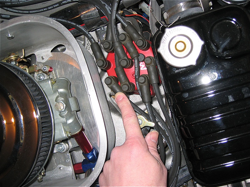

11-04-2009, 02:53 PM
Posts: 22,017
Two More Shots

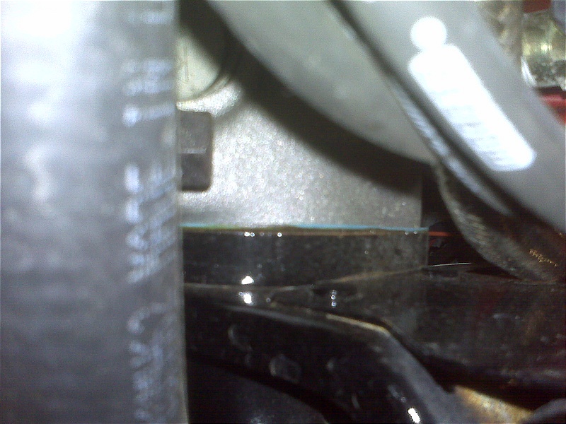

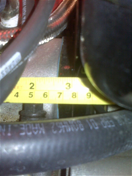

11-04-2009, 03:05 PM
Join Date: Jan 2004
Location: St. Louis,
Mo.
Cobra Make, Engine: 427 S.O. Dual Quad / Cobra undecided
Posts: 1,380
Without the spacer the edge of the E tank was just barely resting against one of the electrodes on the dizzy. It wouldn't take a much time for engine vibration to allow scoring of the rubber boot from the seam on the tank. As well I use the same oval air cleaner without problem.
This is the distance I accomplished
11-04-2009, 03:08 PM
Location: White Plains,,
NY
Cobra Make, Engine: ERA140, ERA 267, ERA GT2038, ERA FIA 2045, ERAGT2077 ERA2893000EXP
Posts: 1,117
The "spacer" is a part of every expansion tank assembly. It is silver soldered to the tube to the tank when it is constructed.
Without seeing what is causing the interference it is hard to say what the problem is. Sometimes the distributer needs to be rotated because a holddown clip or other obstruction on one side or the other of the distributer is hitting the tank. It is a snug fit under the best of circumstances.
Jim
