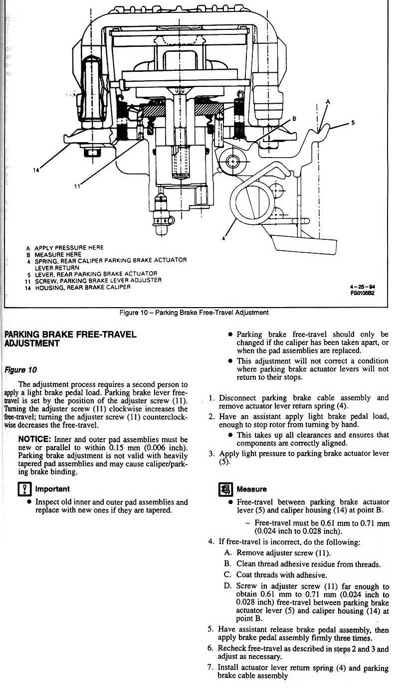

Allen, if your parking brake isn't obviously dragging, then check the stuff Bob P. mentioned, and then just replace your pads with some quality stuff, and then check your free travel as per below:

From that diagram you posted, I'm wondering what the smaller springs are for that are adjacent to the measurement point "B". I do remember from having the wheels off just recently that the one end wasn't connected to anything.....wonder if we are on to something here... Are they return "helper" springs for the caliper pot?

I will take Bob's advice into account for sure.. but my line of thinking was in-line with Patrick's suggestion as the ERA rear was assembled by the previous owner and I figure since he has always had the excessive brake dust issue and the spinners are "warm" after a drive relative to the fronts, I suspect there could have been some error made in adjustment.
But to respond to a previous suggestion, yes, I've made sure that the e-brake lever is in the fully released position.
Can anyone respond to what the two little coil springs are as shown in the diagram? Are they "helper" springs for the pot as I suspect? I know that one of them on the passenger side isn't connected to anything on one end of the spring..
- Allen.
I think so. Go to the owner's page on ERA's site, then go to the Manual Supplement page, then look under "Brakes" and click on Pad Replacement, Rear GM. That will open up a PDF that shows the overhaul of the caliper and pictures of those little springs, like this:

hmmmm...Parking Brake collar return springs... I'll update this thread with what I find when I can pull the wheels off later this evening. Thanks again for the info and reminder of the suppliment pages on the ERA site!

Well, turns out everything checked out OK last night. Put the car up on stands, pulled the two rear wheels and did a visual of the rear calipers and checked the adjustment of the e-brake cable. Turns out the hook on the end of the tension spring for the e-brake collar isn't supposed to really connect to anything...the tab on the collar actually sandwiches in between the coils of the tension spring...which seems strange to me. Confirmation of this can be seen on the .pdf file on ERA's website for brake caliper replacement/reconditioning. So working my way up the car, I pulled the cover for the master cylinders and aside from the fact that my front and rear master cylinders were swapped relative to ERA's diagram for balance bar adjustment, all appeared fine there as well. The balance bar was biased the recommended amount to the rear master. So for now, I'll just keep an eye on the position of the e-brake handle - making sure it is fully in the released position. My car has a Series 1 Jag handle and I found that at it's absolute lowest position, the button of the handle remains pushed in. The claw that rachets on the e-brake rack must be riding on the beginning of the rack in this position. I'll remain concisous of this while driving and see what my hand senses on the rear spinners after my next run.
