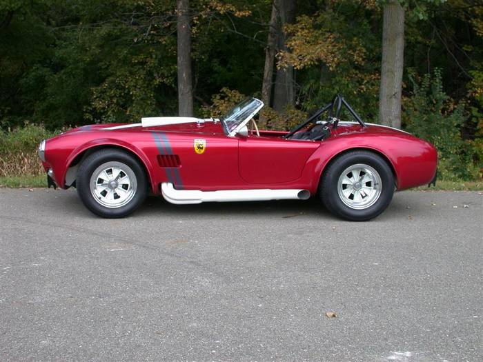

I laid mine back as far as it would go, using the generous holes in the windshield frame:
The windshield rubber gasket sets down fine. I did have to make a number of modifications to the soft top
bows to get it to fit. I started a custom set of side curtains, but have never finished them.

Photo of Jeff's FIA windshield looks great! Could you measure the rake angle?

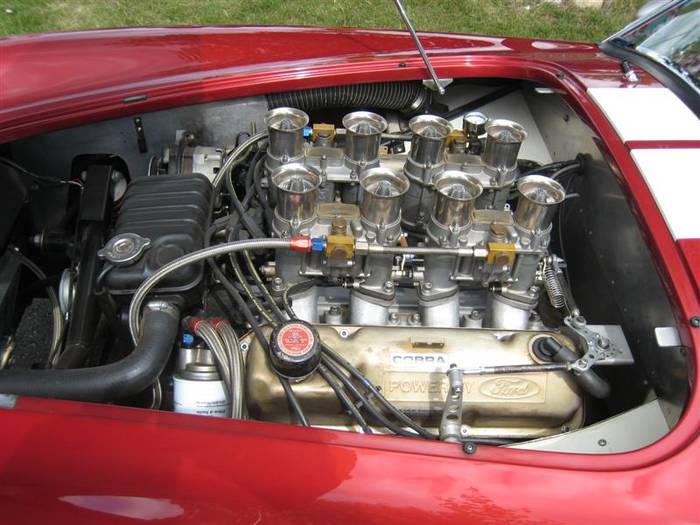

I moved all of the electrical off the firewall in my car, too:
I re-routed the main harness behind the firewall, and mounted the fuse panels under the dash. They're not very easy to get to like that, but, I liked the cleaner look on the firewall.
Will try to get out to the garage with a protractor later today.

Measured my windshield angle at about 43 degrees.
