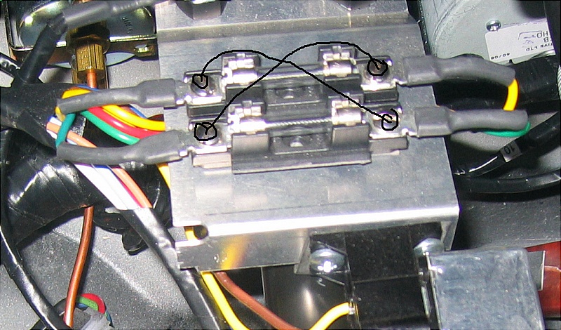

Don, what I would do is pull the two fast blow fuses out of the fuse fixture and put them over on the workbench. Then I would jumper across the fixture as I have marked below with two pieces of wire with alligator clips on the ends. Then test out your lights on both sides of the car and tell us what you see.

What will be cool is if, with the jumpers affixed, you signal a left turn and your front driver side signal blinks but no rear lights blink at all but when you signal a right hand turn the front passenger side signal blinks and the rear driver side signal blinks.

Patrick:
With the jumpers in place the previously dead driver side rear turn signals function normally and the previously normally functioning passenger side is dead.
I am guessing that this would indicate a bad relay. Is that your conclusion?
DonC

Well it's not the ground, that's for sure. It is either the relay itself, or the yellow line that is feeding the relay. With the jumpers removed, fuses installed, and the left turn signal on (and the front driver's side bulb blinking), measure the yellow wire that is running to the trailer relay. It should be showing a "blinking 12v" signal. If it is showing 12v, then the relay is faulty. If you are not getting 12v through that yellow wire then there is a break in the yellow line's circuit.
