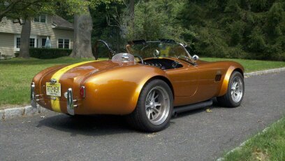

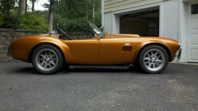

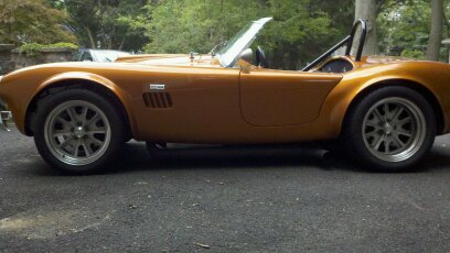

 I’ve had my ERA for almost a year now and have put roughly 700 miles on the car. As summer comes to an end I want to start preparing some winter projects for the car.
First on the list is the way the 17in wheels look. I don’t like the way they fill out the wheel wells and I would prefer knock offs instead of the bolt on rims. The car is definitely sitting too high in the front as per the ERA manual. The chassis is set at about 5 1/4in all around which is about ½ an inch too high in the front. The mammoth tires (front 275/40, rear 335/35) also makes the steering feel a bit heavy for around town driving.
I would like to take the suspension down at least ½ in the front to 4.75in, possibly even a little more before I change the wheels. I would like to see how the17in wheels fill out the wells before I make the decision to replace them with 15in wheels. What height do most of you guys have your FIA’s set too, and how much ground clearance do you have with your under car exhaust. Right now my exhaust only sits 3in off the ground at the lowest point and I’m afraid if I take the suspension down I might run into (literally) speed bump and curb issues. I might need to do some exhaust work and tuck the pipes in a little closer, but I am sure that will require some additional heat shielding.
If I do go the whole distance and switch to 15in knock offs how big a job and how much do you think the whole process will cost? Right now the car drives perfectly (with the exception of the heavy steering) so I am a little concerned to mess with a good thing. I would hate to spend a decent penny and end up with a car that doesn’t drive as well. Aesthetics and street driving are my primary objectives because I doubt I will ever track the car.
I also have one other nit picking issue and that is with the flex in the dashboard. When I am parking and have to apply brute force to turn the steering wheel the dash (where the steering column is attached) flexes about ¼ inch. Translated out to the end of the steering column where the steering wheel is and it causes about a ½ move in the steering wheel whether up or down. I was wondering if anyone else had any issues with the strength of their dash boards (race dash) and how they resolved it. Overall this really isn’t a big issue, but I still want to make the car as perfect as I can.
I uploaded the pictures to an album on my site, but can't get them to post here (why is it so difficult) if anyone wants to take a look. I'll try again tomorrow to attach the pictures to the post.

nice looking car
i like the color...looks aggressive with the big meats

There are two ways you can go to get 15" knockoff wheels, either purchase and install 6-pin hubs from ERA and get 6-pin knockoff wheels or go with adapters for your existing hubs and 5-pin knock off wheels. Trigo makes both kinds. The more authentic (and thus the more expensive) way would be the 6-pin hubs, the less expensive route is the adapters. You will have to figure out the proper backspacing for the wheels depending on which route you select. I went for authenticity.
The ERA manual specifies 4.75" front/5.25" rear ground clearance (on frame). I run a little less than that with the 17" wheels/tires, since they are only 25.7 inches tall. I'm running 275s up front, 315s in the rear.
Have fun with your winter tweaking!
Gary

The adapters should not look any different that the 6-pin hub version from the outside, only you will know. The new wheel backspacing will be the issue you will have to deal with. The adapters will add 3/8 to 1/2 inch to the hub, so you will have to have a backspacing on the wheel to account for that. Bob P at ERA is good about helping you sort out backspacing.
As far as height adjustment, I believe that the lower control arms in front should be parallel to the ground, and the rear should be "raked" 1/2 inch higher. I don't think you want to try to set the heights as in the manual unless you have tires which are the recommended sizes. I'm running 4.5"/5.0" front/rear.
Unless you are going to do some serious track work, I don't think you will need to corner balance. With the ride height set close to specs and equal on both sides, the corner weights are going to be pretty close.
My car has the undercar "street" exhaust which I modified to exit in front of the rear wheels, so I have close to 4" of ground clearance, but I still ding the mufflers sometime.

As for the heavy steering, you might want to go with the larger dia Moto-Lita wheel. It's the same size and looks as the original, and makes steering a little easier. You also may have too much negative camber. If these changes don't work for you, look into ERA's new power steering setup. (The big Moto-Lita looks great).

Well on my car I did the exhaust different than ERA has it. I saw too many FIA's that looked like they were riding too high in the front and the exhaust was just barely off the ground. On my car I "notched" the outer frame extensions and boxed them in where I removed the material. I basically took a 4" hole saw cut out the material and then re welded a curved piece back. The results are my exhaust sits actually higher than my frame in the front then flairs a little more downward in the rear. The only downside is there is more heat build up but I just installed more Dyna mat there to help and it's perfect. In my opinion mine looks more "original" and definitely works great. I haven't ever scrubbed one time over any speed bumps.
As for the Trigo's, I believe they only offer one offset for the ERA FIA. I got mine from Lynn Park at the time he still owned them and he knew exactly what I needed. The wheels are different front to back also in bolt hole spacing. The adapters work great and the wheels "ARE" the right ones for the car ( they look better than others). I run 235 60 15 up front and 295 60 15 in the rear. My car absolutely drives fantastic and handles pretty impressively with low speed rated tires! The 17" wheels don't look bad but there is a lot of compromise with both. The 15" tires are getting harder to come by and most here say the Avon's are the way to go. As far as lowering your car, be careful as when you lower the car not only do you change the corner balances BUT you will have to re align the both ends of the car. Do you have any rear end shims for the jag rear end, they are special. I set my car up exactly as ERA suggested and then had to add shims to both sides of my rear end. I actually put drivers weight in the seat also. With 235lbs in that seat it does have an effect on how it's set up. The front I eye balled (2 foot level and a tape measure) and when I took it in to be aligned the drivers side was perfect and the passenger side needed only a couple 1/8 shims.
There is a lot more involved when lowering these cars, not that it's hard just involved. There is a lot of things to consider and I would call Doug at ERA for advice too, he's tha man! Glad to hear you got everything worked out and are now enjoying the car! If you email me, I'll try and dig up some pics of my exhaust mods. Best Regards, Matt
