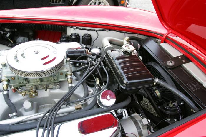

Is there a pattern or template of where the three fluid reservoirs should mount on the driver side engine bay aluminum? I didn't see anything in the manual or the Owner Supplements.

No template, but here's a reasonable shot of mine, as installed by ERA. Ignore the stuff on the clutch reservoir, this shot was taken during a leak repair session.

Patrickt - it looks like I will end up with a very short piece of rubber hose between the reservoir and the chassis tubes - so I guess that in a way will dictate their location. And it looks like the back one has to clear the chassis brace that runs below it. I'm about ready to install those engine compartment panels and was going to pre-drill the holes first but now I think I need to do it after the panel is installed.
