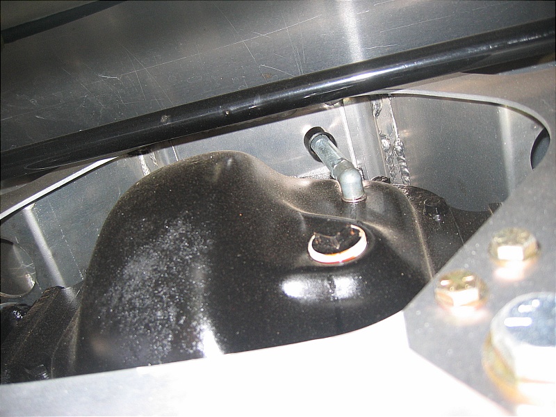

just wondering some thoughts...I don't drive my cobra very often but i recently noticed some red fluid seeping on the bottom of the back diff. (the diff is the ERA outboard brake set up) (the tranny is a tremec 5 speed). There is a drain plug on the bottom of the pumpkin but I don't think that is where the fluid is coming from...looks like it is coming from on top somewhere where the driveshaft is.....
any thoughts....

Take a look from the back, upwards to the top, and see if maybe your vent tube has gotten dislodged/broken/leaking. Or at the very least you should see a telltale trail. Here's a pic of mine so you can see what I'm talking about.

thanks patrick...i did check that last night but that part of the pumpkin is bone dry. it is a very small seepage and the trail seems to point to the front of the pumpkin...i will spend some time with it today.
