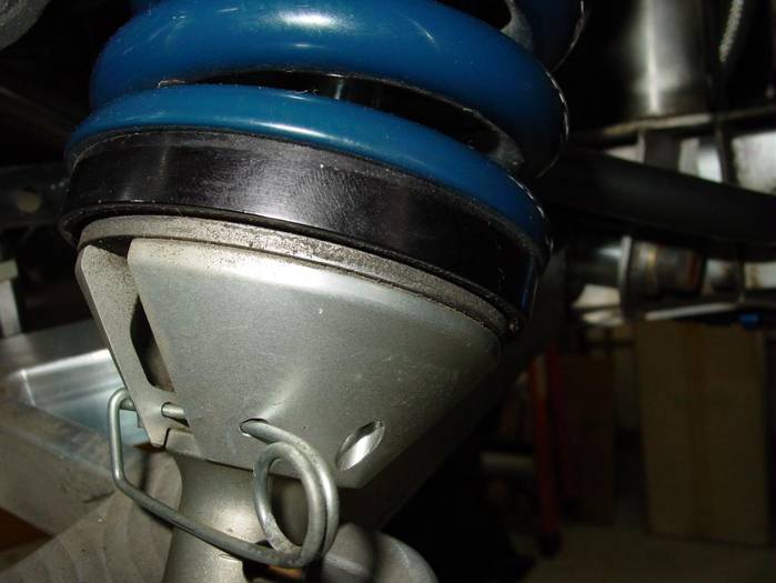

On the rear shocks we use a Torrington Thrust bearings with two spacers....under the spring.
Morris

Take a look at this .... you are missing the trick....
With the Thrust Bearings the spring is allowed to move around the shock in a circular motion as its oscillating up and down....So the collar acts as a locater for the helper spring and the Spring.... but it also hides the thrust bearing that the main spring is sitting on and allows circular movement as it moves thru it's travel
This does two things.... it keeps the spring from binding up as it moves thru it's travel in all directions.....
And it allows you to make height adjustments easily by just using your hands to turn the spring up or down as you need 1 or 2 turns at the track to get more temperture in a particular tire..
Morris

Morris thanks, I see that now.
A little off topic, but what is the advantage of allowing one end of the spring to freely rotate as it is compressed? We are just talking about a couple of degrees of rotation? Can this be a benefit to a street driven car?
Old 12-11-2016, 08:29 AM
Join Date: Dec 2003
Location: Gurnee, IL
Cobra Make, Engine: Kirkham #259
Posts: 1,396
Wolf
Anytime you can take a bind out of any suspension .....the suspension will respond accordingly....and give you more accurate readings.....btw....it moves more then a couple of degrees...depending on the amount of travel....
And it's easier to raise and lower the spring height as needed.....street/track/autocross/speed bumps.....
Morris
