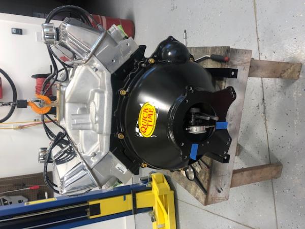

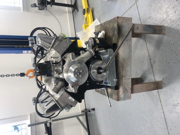

Originally Posted by Grubby
The engine for 838 is done and home. I will get it dressed and the bell dialed in while I patiently wait on ERA to finish the car.
John
A QT bell will be dialed in before lunch time. A Lakewood takes all day, sometimes a week, occasionally a month or two.

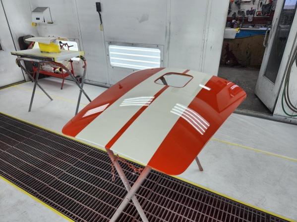

838 went to Big B for paint on 10/24. He estimates it will be painted by end of February.
Then ERA has to do some magic. Car should be ready for pick up end of May.

Bell dialed in some months back. It was farther out than expected. Around .010” runout.
I used the Lakewood weld on kit that positions the dowel holes in the correct location. It ended out at about .001” run out.
Nothing to do until ERA sends rear end parts for assembly.

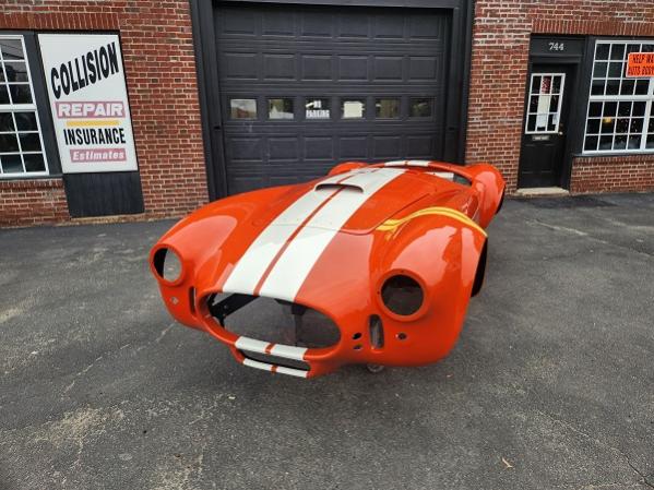

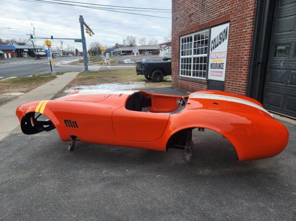

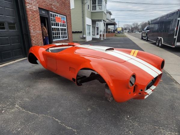

838 was returned to ERA on 12/27 from Connecticut Custom. I love it. The colors turned out perfect.
Peter didn't know when it would likely be completed at this point. He will advise later.
After speaking with another ERA owner that found a way to mount a more correct ratio steering rack, I plan to do something similar. Flaming River will sell a rack that is nearly identical to the ERA spec rack with 15:1 ratio instead of the standard 20:1. This is much closer to the original Shelby steering ratio and nets roughly 2.25 turns lock to lock. The only difference is the input pinion is longer.
I will see what Peter says about it and then do it locally if needed. I have a good friend that has a Bridgeport in his basement and he confirmed this can be done without taking the disassembly of the rack. It seems like a no brainer for a new build. I have to buy a rack anyway.
